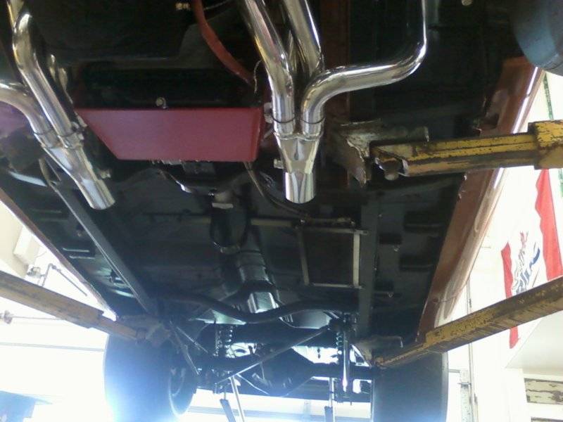

Its normal. The entire drive train is not centered from the factory. Front of the engine is off to the right. Late or early trans doesn't matter the both set on the center of the cross member. Not the best pics but this is how it sets in my 64.

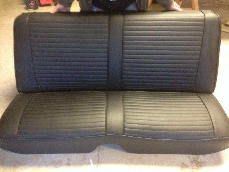

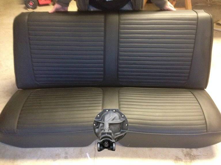

THis picture of the rear seat bottom for a 69 will show you how far off the hump is to the passenger side.

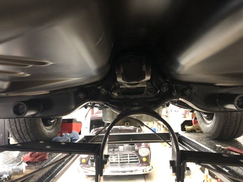

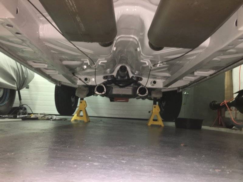

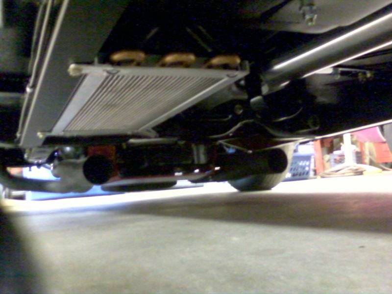

Sorry for the crappy picture, I went back and looked at it and thought I was seeing mufflers. had to do a double take, that's the floor. I want to go with the bigger U joints, 1350 I think. I hope I can center in the tunnel so the bigger yoke don't smack the floor. Sounds like I'll have to message it a little.
Here's a pic of my 65. The motor is offset to the passenger side, as all motors are. I use the Schumacher poly motor mounts. Also a poly trans mount. I use 1350 u-joints with no clearance problems, and a driveshaft loop.

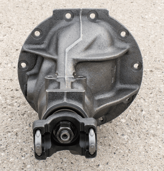

Don't overlook the differential pinion by design is offset to the right to keep axle lengths equal. I believe most manufacturer's tried to keep the differential and engine/transmission aligned in this plane, leaving the up/down plane to provide for u-joint roller action. Side benefits - slightly more room for steering gear and often the battery on the left side.

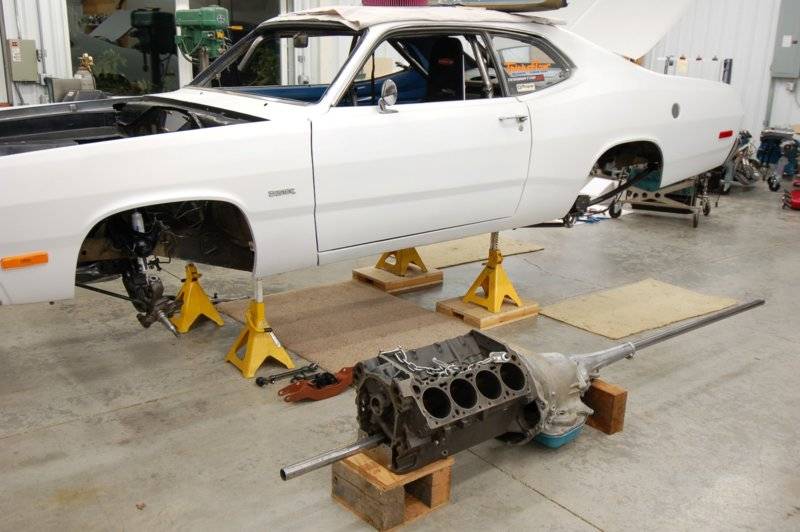

I think you have something wrong in that picture. The engine and trans should be centered, or closer to centered than how it looks in that picture. When I build a car I slide a long pipe thru the engine and trans and point it at the pinion yoke. That way I know everything is lined up properly.

Here this will help out even more... lol It really shows you how it centers up the rear axle when you can see the tunnel hump lined up.
