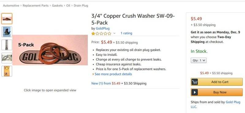

These gaskets I believe more like factory. Replace with a new one every time, I don't know. Don't if you use paper gaskets, on Hemi crossrams bolts are in manifold. If you use paper gaskets retorque manifold until bolts hold torque. I torque them every few hours and check next day. On Hemi's if you don't bolts can be sucked into engine.
