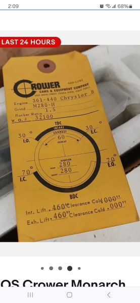

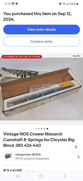

So I was searching for a old school cam and stumbled upon this cam, snapped it up . I like the new old shool stuff, lol! I am seriously thinking about using though in my 383 build.
From the info I can find, it seems it was a good little cam for those who used it, I picked up matching springs as well. Any reason why not? 383 .040 over, 915 small exhaust heads, 10:1 compression, 323 gears.
224 @ 050, single pattern, 110 LSA. Should work well. Find some old lifters & have them re-faced to ensure you do not wipe out the cam.

I would be happy to get under 14 seconds, lol! Glad to hear the positive comments, I kinda bought this on a whim. The fella I bought it off said it is still in the original packaging and in perfect condition, seems like it was a good purchase on a good old school piece...
