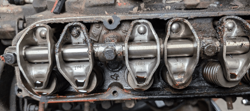

I have a second RV 440 (RV had 20k miles) that I planned to use initially. Unfortunately, the low miles meant short runs and the top end was rusted up from sitting.
Low mile engine rust. The non-rusty parts look extremely clean. It was a shame that it had so much moisture in it.
To remedy this, I planned to have someone disassemble and inspect the bottom end, hone, new rings and bearings and run with some new top end parts:
