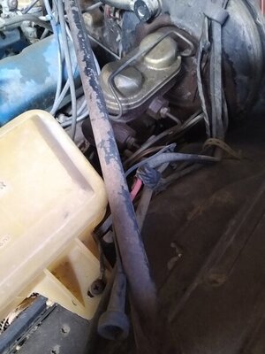

Here is the speedo cable to the cruise unit, where does it go and where is the other one.

It does have disc brakes. There is no N88 on the fender tag.
you could get cruise on a power drum brake car, but yes they need to have power brakes with cruise.
Actually it looks like a speedo cable in the pic but it is a really unusual push on wiring connector that is part of the factory loom. It is just kind on hanging out in that area. I will try to take a better picture of the connector and post it tomorrow.

Thanks all for the input! To answer some of the comments see the pics . The item that appears to be a speedo cable is an unusual wire connector. There is a bracket bolted to the two left bolts of the master cylinder but it is only holding the wiring loom. Guess once I start tearing the car down I will see if the wiring from the turn signal is connected to anything!

Might be the wire to the proportioning valve
Sorry-I didn't see the power booster. But it does have the wrong master cylinder for disc brakes.
