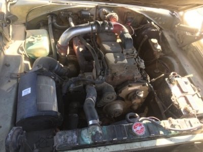

Just last weekend a guy was here with a 68 Plymouth wagon with the 4bt? In it,sounded like a lawnmower,he said it got like 34mpg.
I have a pic or two and a short video.
Well, Post it up. No one likes a tease
