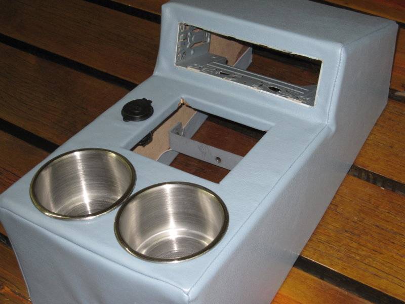

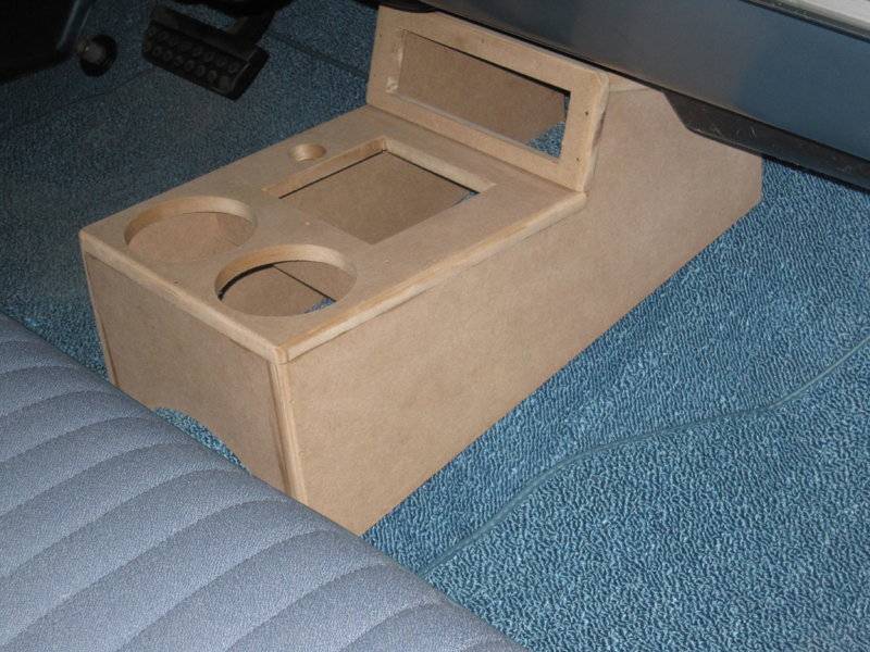

I posted photos of my console construction here late last fall. I used 1/2" MDF board. It is nice to work with and the design is only limited by your imagination.

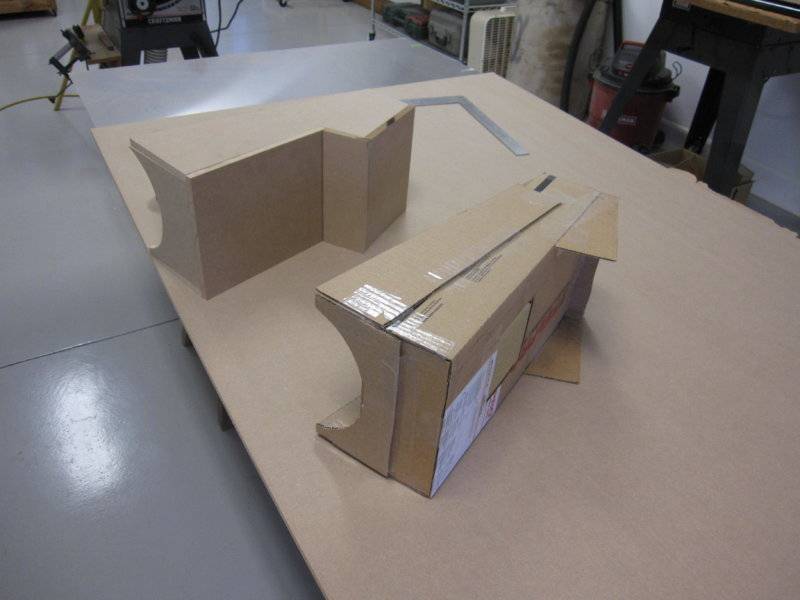

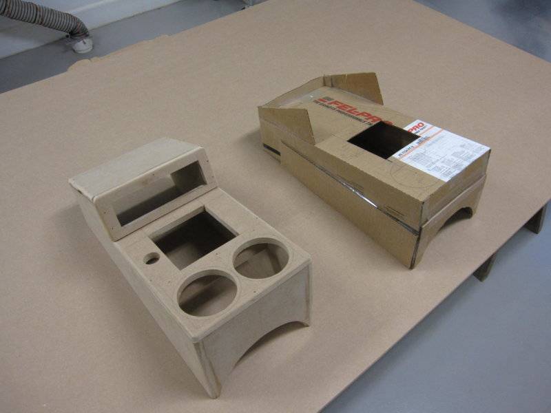

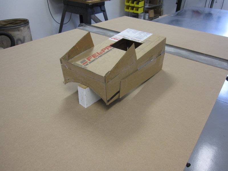

493's console looks great and my only suggestion would be to mock it up with cardboard (which 493 did). You would also make the console out of sheet metal if you wanted to, but 493's idea is just fine.
