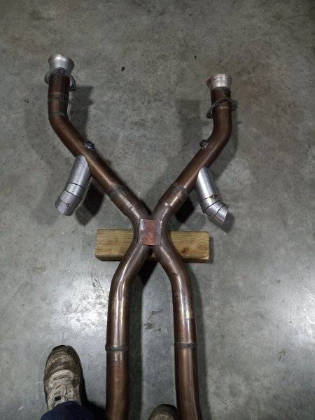

Here is a picture I took while welding things up . I run the sensor on the passenger side.. you think that's still to close to the cut out ?

Yes I believe that is too close. Your mixture is probably fine, you are just throwing the gauge off.
I had a similar issue. Turns out the cutout (when open) pulls air in from the exhaust contaminating air farther up the pipe. Also, you have a very low pressure situation at that juncture. As far as the O2 is concerned, it's setting about 2" from your tailpipe. I suspect a better spot would be just behind or at the neckdown. But, I don't know what headers you're running... standard log manifold, shorties, etc. (I'm assuming shorties?)

Really should have the sensor in the header now. And make sure the header collector gasket is sealing.

Based on what you're sharing, I think you're dealing with a O2 placement issue. Also, those headers are plenty long enough, meaning the bung could be moved pretty far up. The "easy" fix is pop another bung in there and plug the current one. There's a min distance you want from the head exhaust port, but most people just say 6-8" past the collector. The really important part is the min amount of pipe you have after the sensor, which is 18-24". In a perfect world.. you'd have the sensor located 18-24" from the engine and 18-24" from the end of the pipe. Once you open the cutout, air is getting to the sensor from the long pipe, negating the length of the cutout extension.

The O2 is reading false. Reversion is pulling fresh air back into the pipe. Idle readings on open headers with the sensor close to the end are useless. I've experienced the same issue.

Move sensor or add pipe to cut out
