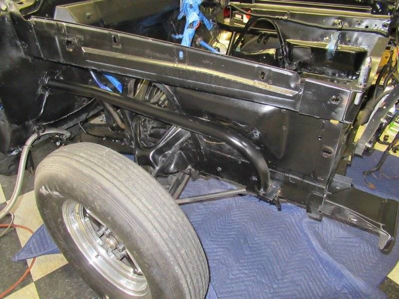

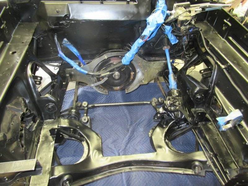

I cut the front halfs out on my 64. Same engine compartment. Drill the spot welds at the shock towers. Then cut right below the radius with a cut off wheel. You can fab ne lower pieces pretty easy.
Doug
DVW that looks great! Thanks for the pics . Gives me some more ideas.

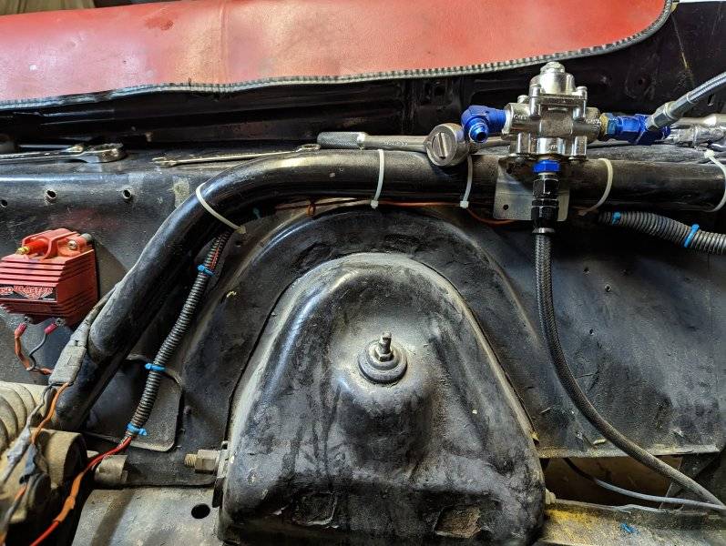

I had to eliminate the shock tower to clear the HEMI valve covers. Then welded shock tabs on the "J" bar.
