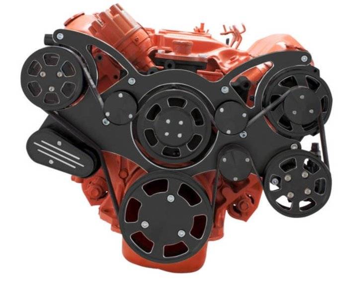

CVF Wraptor serpentine system with "GM type 2" power steering pump. What power steering box is best?

I want to make sure that whatever power steering box I replace my manual steering box with is compatible with the Wraptor's "GM type 2" power steering pump.

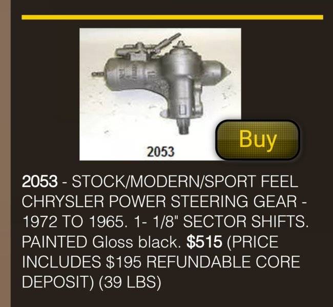

So it looks like this is the unit I should buy for my 1970 Roadrunner.
I only have a manual steering box, so I am going to sell it here at FBBO or see if/what SteerAndGear would give me for it:

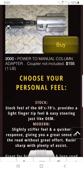

Does this "power to manual column adapter" adapt my manual steering column TO power?? Is this the solution? Or should I look at the "rag joint" I think I've seen? Also I assume "Level 2" is what they call "Modern"?

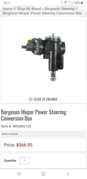

Mancini has this Borgeson power steering box for $567

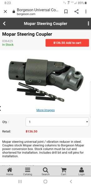

But then it looks like I need this too...
Do you know if I need some kind of adapter or U-Joint with the SteerAndGear?
The power box is longer than manual, so I don’t think you’ll need that adapter. You may need to shorten the column?
The Borgenson box is bolt in, but an adapter u joint is needed. Do not buy theirs!!! Way to expensive. Get one from eBay or other place. That box is really nice, you’ll need adapters for the hoses though.

I've read that the column shaft has to be cut.

Borgenson box is nice, if you get that on, you will like it. I think the type 2 pump uses a 5/8 inverted flare, and the Borgenson box uses a 18mm to -6 and fittings. They are machined for the box and are stainless!

For MY application, cruising roads and highways, and at the drag strip, is the Borgeson BETTER than the SteerAndGear or vice/versa, and which one is smaller?
It’s a quicker ratio, but the other 2 are just a good, but in my opinion, the Borgenson edges them both. It’s smaller, lighter, faster, and I think you’ll like it much more than the stock boxes that are gone through.

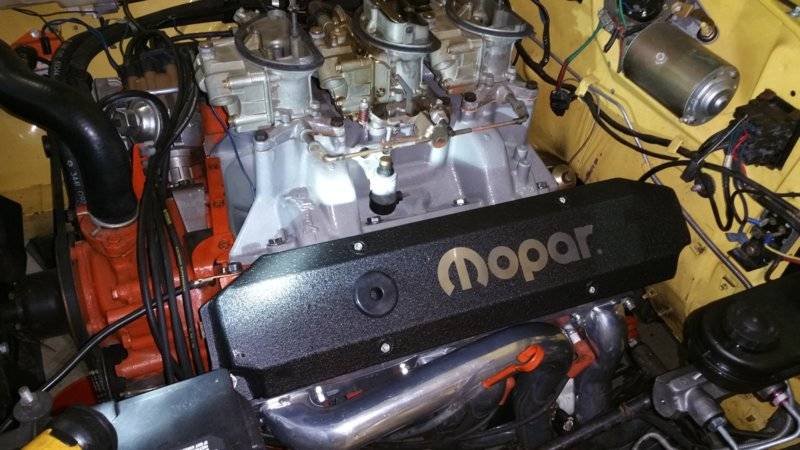

I got the Black Diamond finish to go along with the finish on my valve covers I like so much!
