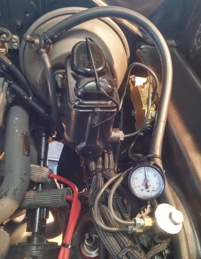

You can also easily add a vacuum gauge for $8 bucks to see what is really going on, see pic below.
