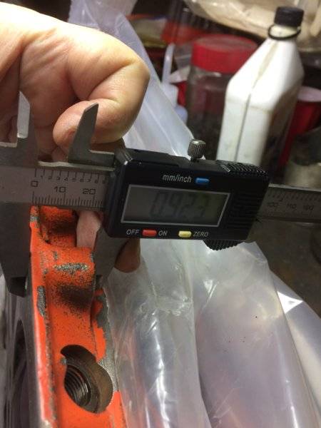

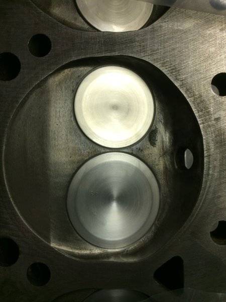

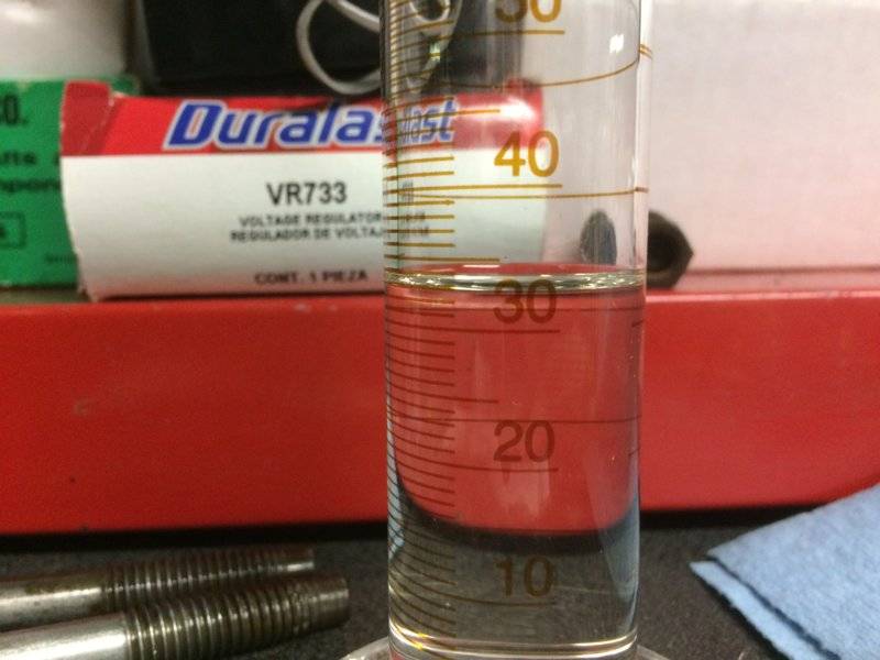

Milled these over .070 to 67 ccs. Been over 7 years no problems
