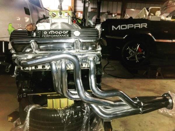

i'd recommend headers with that engine combo. headers will free you up on head choices. I use 2" tti's with edelbrock rpms and plug changes and plug clearance are exceptional.

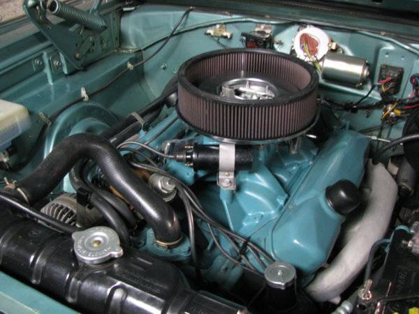

I use Performer RPM cylinder heads no problems with HP manifold...

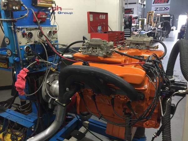

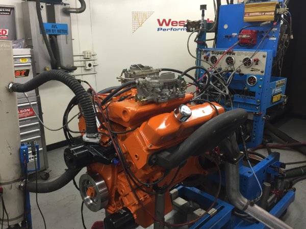

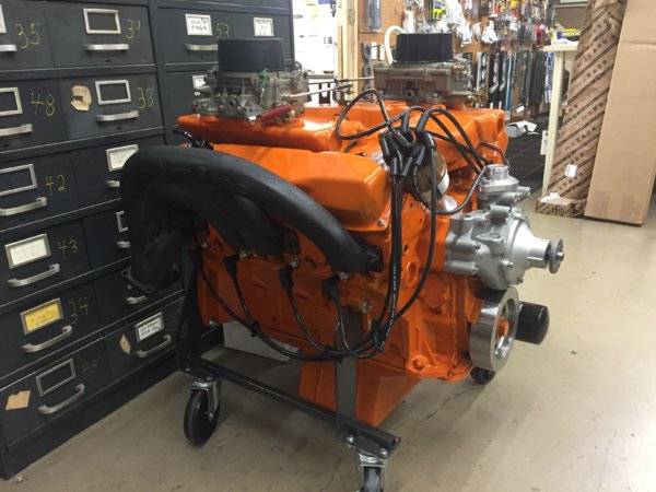

Max Wedge Victors with Original Max Wedge Exhaust Manifolds and original '64 Stage 3 intake

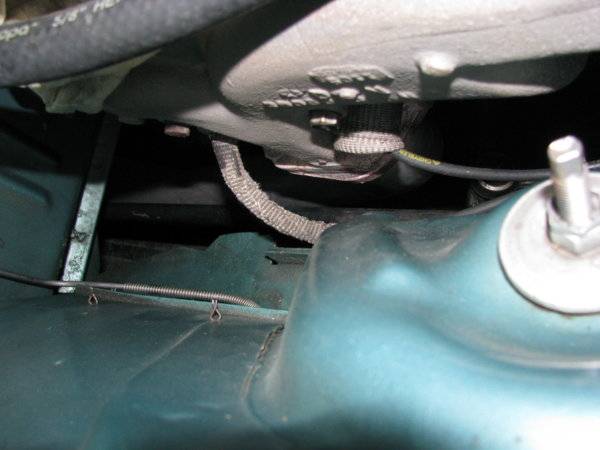

Just use spark plugs blankets for the last two passenger side spark plugs..

It seems as if the angle of the spark plug tips towards each other would give you more clearance than even the stock plugs have. They point AWAY from the exhaust passages in the head and manifold. I used Jegs/Patriot headers on my Performer RPM heads, and they cleared really good, other than having to make a couple of small dimples in the header pipes for additional plug boot clearance.
