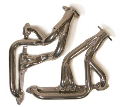

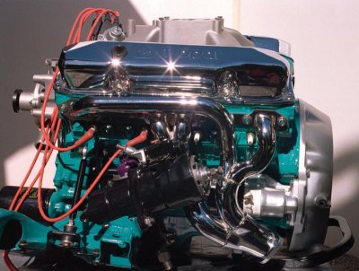

You may want to try TTI Exhaust @ www.ttiexhaust.com or Schumacher Creative Services, Tri-Y's "maybe" @ www.engine-swap.com , photos below of BB Wedge Tri-Y's, I know they make them for the BB Wedges not sure about the SB Wedges... I wish someone made a shorty header, like the ones made for the 1995-2001 Ram/Dakota 5.2ltr./318ci or 360ci/5.9ltr. Magnum Headers, rear exit direct replacement, for BB applications, that would replace the stock 1968-70 HP manifolds... I think a "shorty tube header" for the Mopar BB or SB Wedges in 66-70 B, A or E Bodies that would be a direct replacement for HP manifolds, would sell very well... You may also want to try Hedman they made a shorty header...
