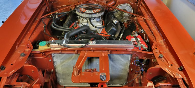

Working on a 73 charger with BB 383 and having a hard time figuring out what headers will clear the steering gear box. I bought shortys and they hit.... Don't really want long tubes but will if I must... Talk to me guys, I know at least one of you have faced this problem. Thanks in advance for your input.
