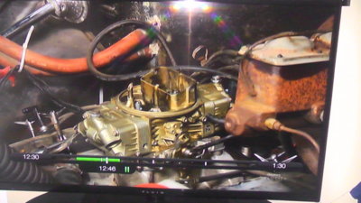

I've bumped into a few "mechanics" like that in the past few years particularly. Getting to be a scarcity of legit guys around these days.
OK, I'm not a Holley guy. What am I missing, the metering plate upside down/backwards?
Thanks!
I would think it would depend on the manifold whether it will affect performance?
Thanks!
Regardless of the manifold and performance, the fuel lines and vacuum hoses need to be re-routed and the throttle linkage is on the wrong side.
