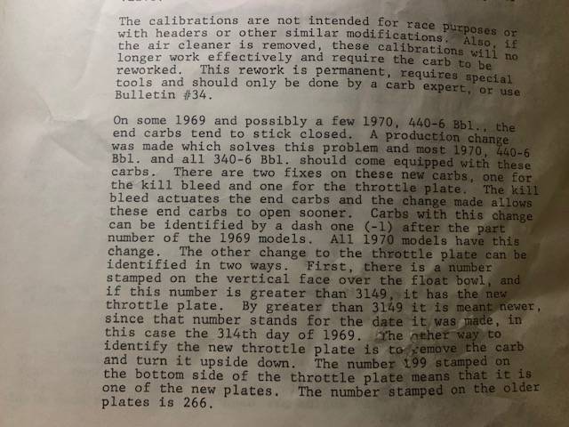

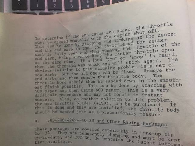

Some six pack outboard throttle plates will stick in the bore. There are a couple of possible causes and cures.
What's the number stamped into the outboard throttle blades? If it's 266 then you have early carbs with a known problem
Oh wow! These printings are GOLD! I try save em when they come up, THANK YOU!
Since they're "New" carbs, I'm sure either one is canted a bit at an angle? Or have a shaft bore sticking.. Ye ole "6 Pack's are Problematic, BUT when they RUN? Be afraid"...lol
Really apreciate that!!

Personally, I would not ask Nick of Nick's Garage fame (?) for the time of day.....the info is too contrived. As for the OP's information, the HOLLEY R-4144 carb is not NOS but at a aftermarket replacement especially for an origional A-12 Road Runner. The information suggested by 1 Wild R/T is spot on as suggested by the Chrysler publication....review it....understand it....it will fix the problem.

There is no need to separate anything. Go out there now, remove the outboard linkage and give the shaft a light twist to open. If there is initial resistance and then is fine after that it is the throttle plates sticking. If it is smooth, close the throttle shaft with a little force, and then try to open again. There is usally a slight pop when the stuck plates opens.
If the throttle shaft drags over a range of motion, it is the throttle shaft, usually due to base plate twisting from over torque and thick gasket.
this is the first place i'd look. not rocket science to fix. some people try to run the linkage tight, which won't work, but that's other issues.
