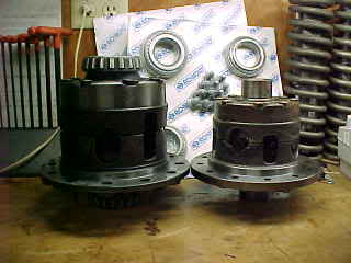

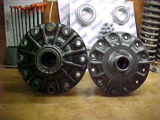

There's really nothing weak about a Dana 60 but that being said, you can still abuse anything to where it become junk, however, the 60 will take much more abuse and will generally last much longer than any 8 3/4. I'll post a pic showing the size difference between the 8 3/4 and the Dana 60 Power Lock in a minute...the 60 is on the left.
Really? I was not aware of that. I figured bein bigger than the 8 3/4 it would have 4 pinions as well. Thanks. Learn sumffin new everyday.
