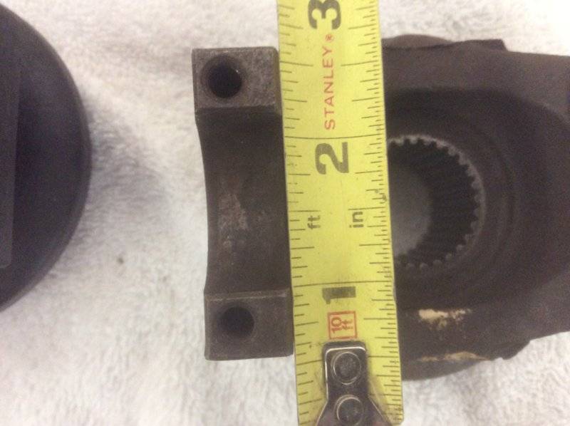

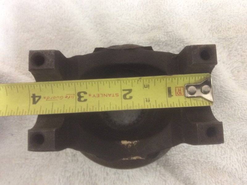

I purchased a Dana the other day for my 70 Roadrunner. My Roadrunner has a 426 Hemi auto right now with a 8 3/4. My plan was to install the rear with all new seals and shorten the drive shaft as required. The issue I encountered was the yoke on the Dana appears to be a 1310 yoke with U bolts that does not use the inside lock C clips. The size is 3 7/32" end to end. What application could this have been from? The rear is 1968-1970 B body size with a pinion snubber. The seller said it was in a 70 charger. The ring gear is 1968. The tube marking and BOM are not legible. I suppose I need to change the yoke to a 7290 type that uses the inside lock clips and U bolts. I understand that 7260 U joints are similar to the 1310 but they use inside locking clips. Any information is welcome.

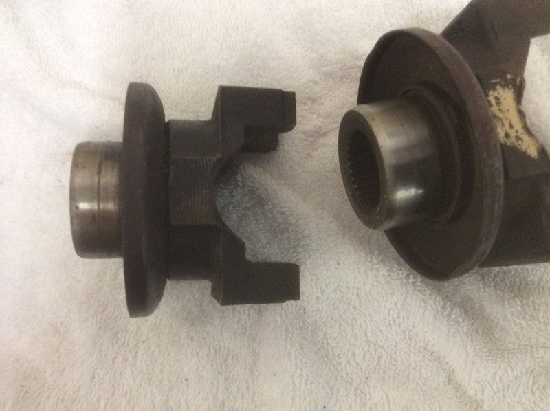

Think I still have this yoke believe it's a 7290. One picture has 2 yokes the one on the right
is the same yoke in other pictures, note no groove where seal rides. No strap or bolts.
Mine yoke presently on the 60 does not have the dust shield. Does that matter?
the correct dana yoke has a little larger dirt slinger on it than a 8 3/4 one. If interested I have a new in the box Victory driveline parts dana yoke with straps etc. pm me if interested.
I understand the U bolt design is stronger. So a dirt slinger is stock. I guess someone took off the original to fit to their application and the original yoke is gone. I guess I could consider 1350 U joint upgrades also since I need a new yoke and the driveshaft needs cut.
