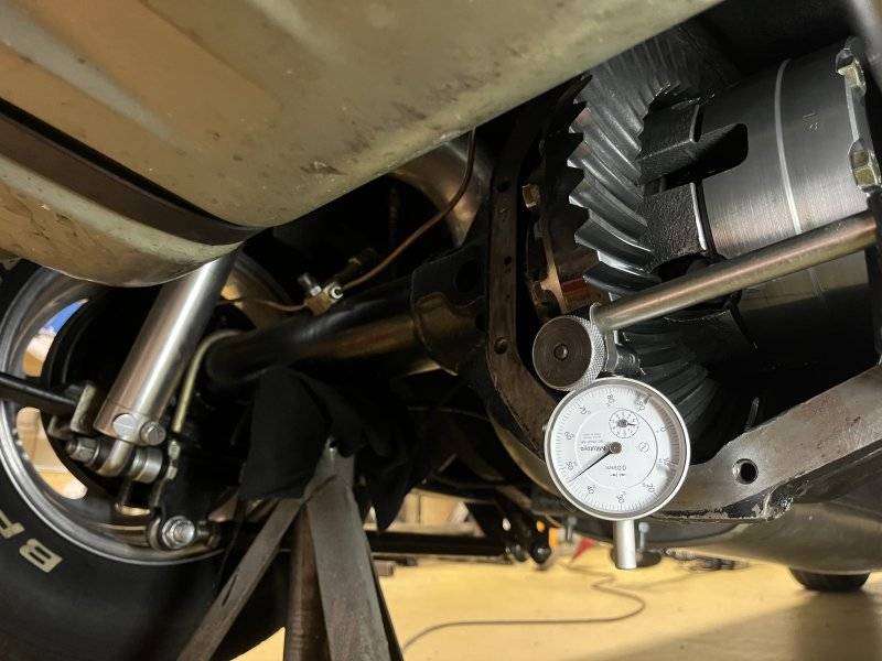

I measure the B/L and now its .011. I check over ring gear and cap bolts, all fine. Oil has no debris or metal flakes and looks as new.
I check have to check the in & out slack on the pinion tomorrow.

Gear pattern looks ok to me and I can not find any obvious errors. Spicer specs B/L to .006-.010 and I have .011 maybe that's the problem?
I’d shoot for .008. But as mentioned already, the gears have mated, I doubt you’ll ever get rid of the noise.
