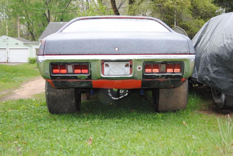

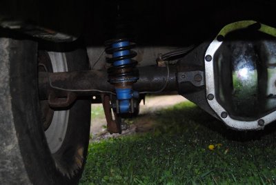

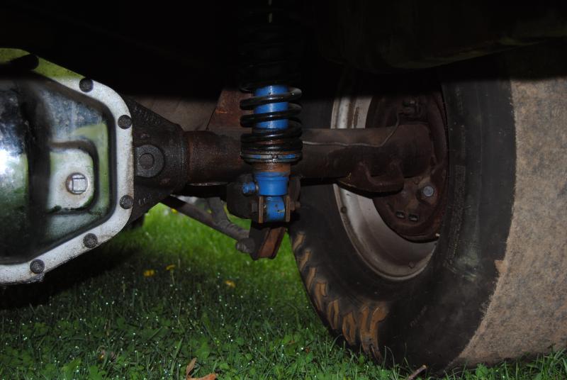

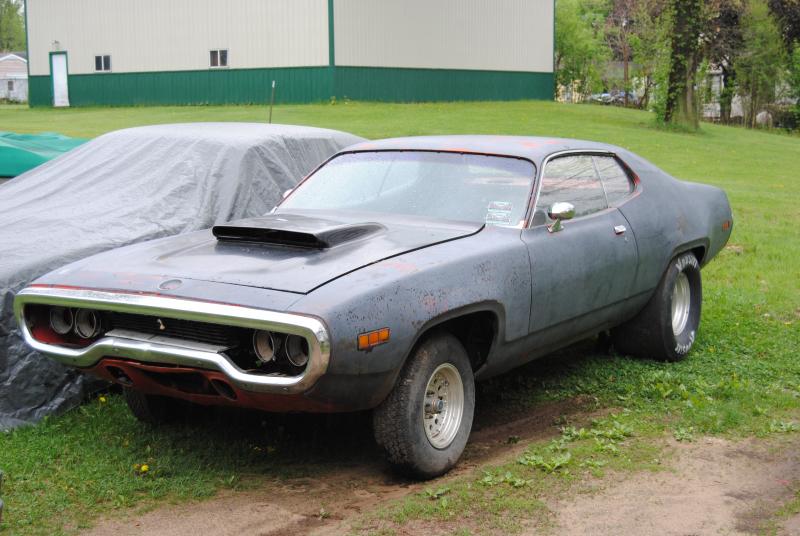

Just bought a '71 RR that was set up as a race car early in its life. Car has no rust except the bottom inside lip of the trunk lid. The problem I have is the car has a narrowed dana under it with 31-14 X 15 racing slicks. No leaf springs, has coilover shocks. Can the existing axle tubes be extended approx. 4 " per side and new axles installed or do I need to have the tubes removed completely and new ones welded in. I think it has a spool in it so that would have to be changed also. As a last resort I was thinking about just finding a used 8 3/8 and installing leaf springs. Going to be running a 440 with about 400 hp .

Looks like its about 52.5" from the flange where the brake backing plate mounts. The tires clear the frame rails by about 3/4 " on each side. I'll take some pics once I find my camera.

Pulled the cover, under one of the bolts was a tag stamped 5.13 and it has a spool. Not much good for a street car. Going to look for a 8 3/4 rearend . I could buy dot tires and a posi for it but I would have as much in it as buying a used 8 3/4 and I already have new rims and tires.
