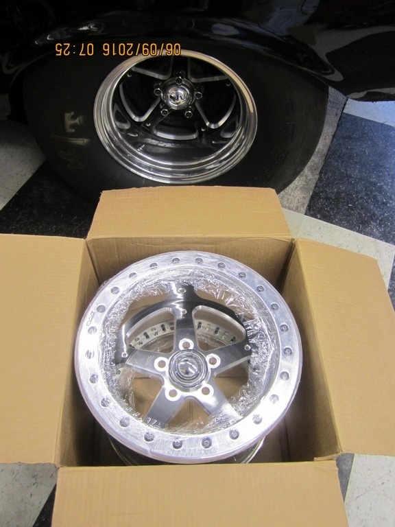

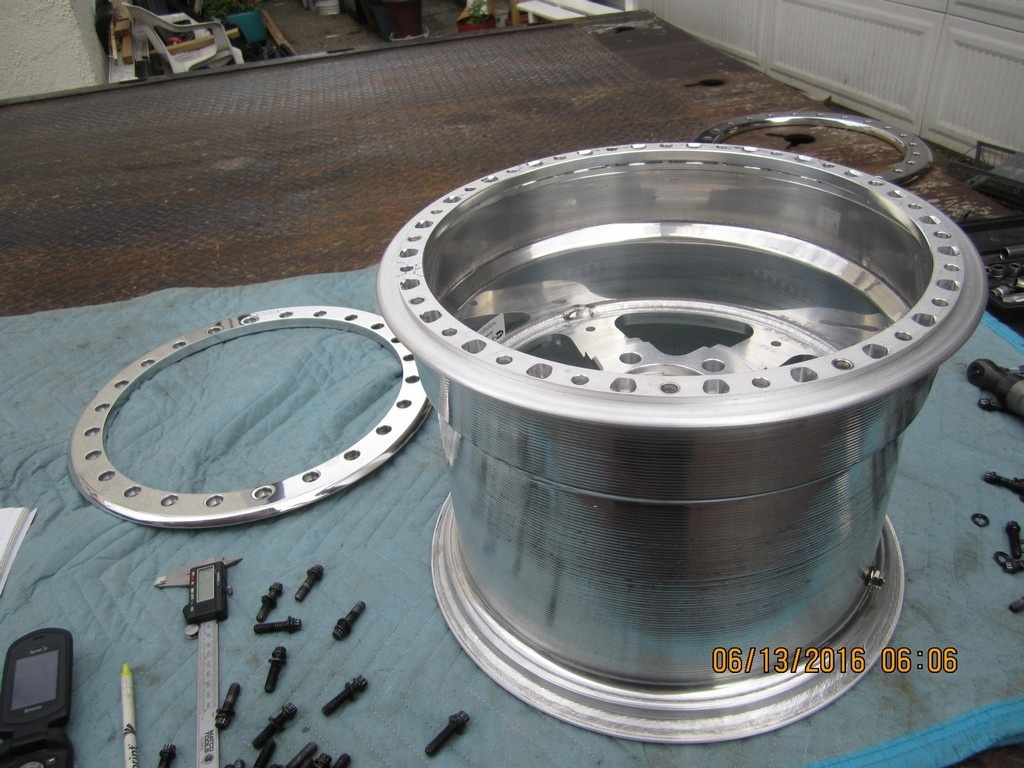

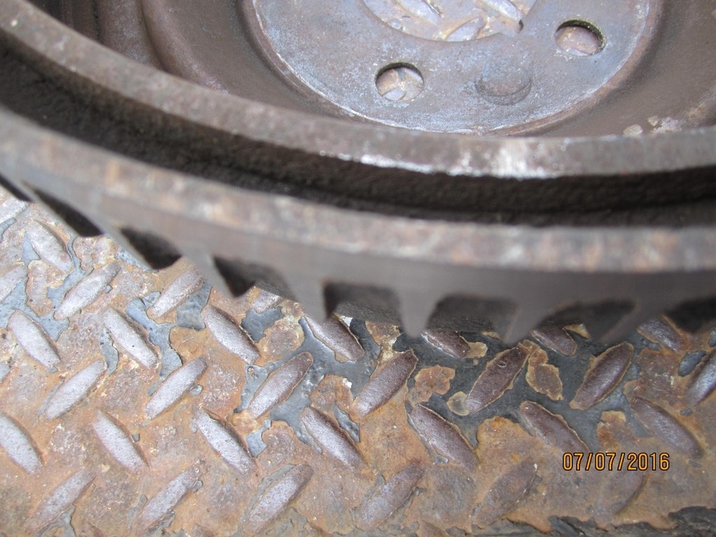

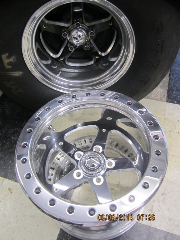

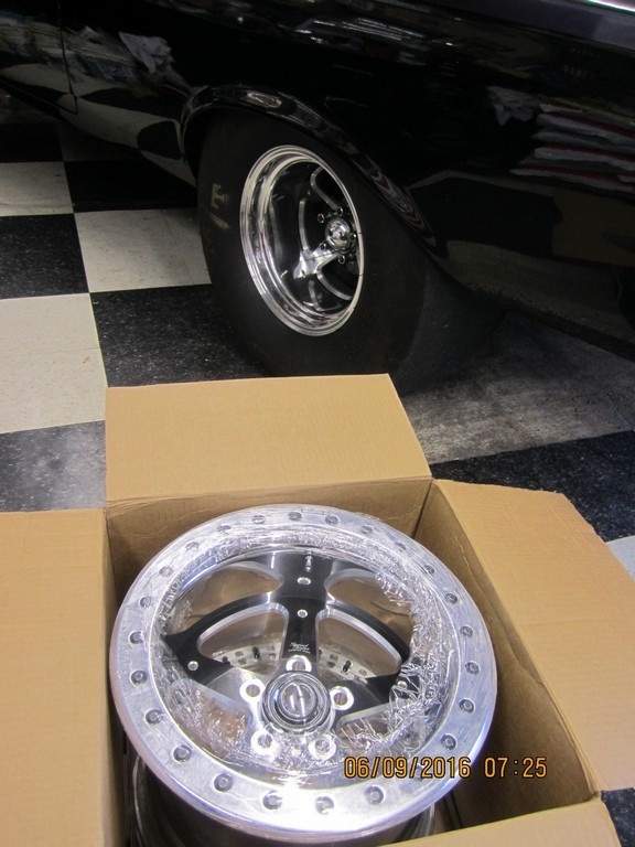

I went to install my new double beadlock rims with new GTR E/T streets and the beadlock ring does not fit over the finned Dana drums. I have a friend that feels he can machine the fins off the drum,I found some smooth drums but these guys are nuckin futz with their pricing.If plan "A" doesn't work then I will put rear disc on:BangHead:

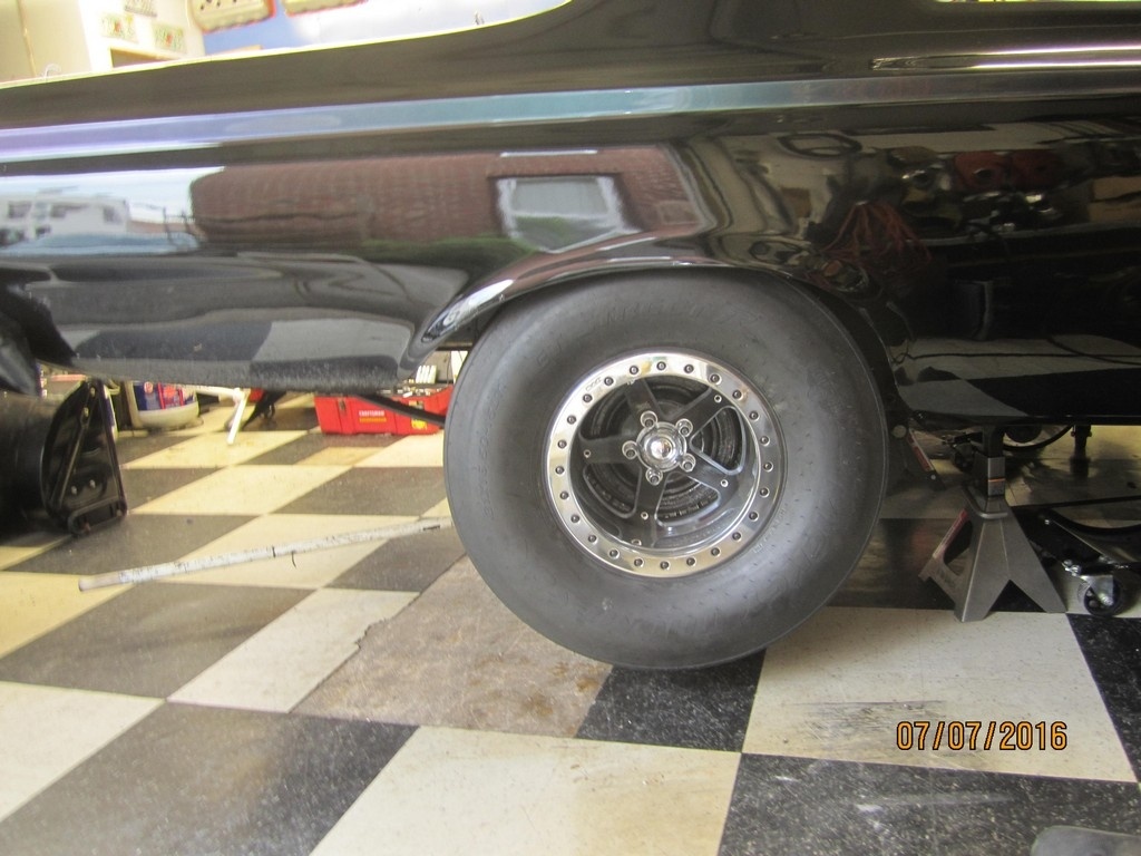

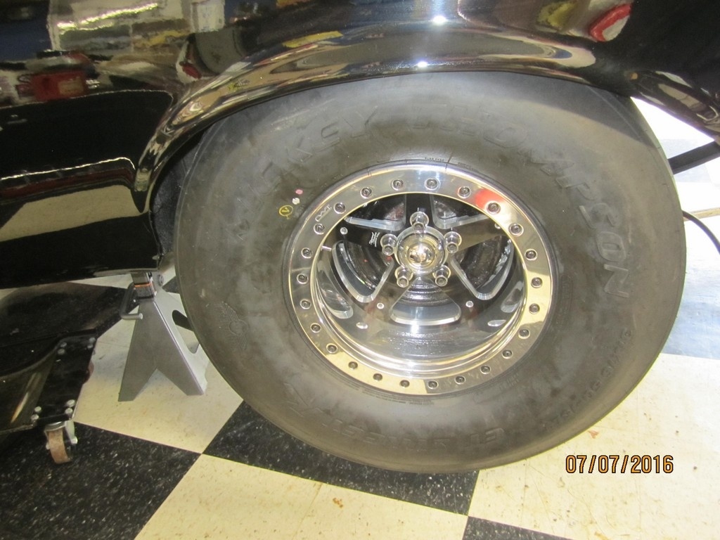

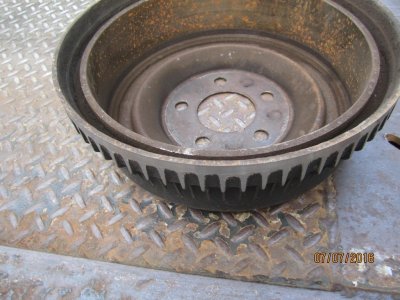

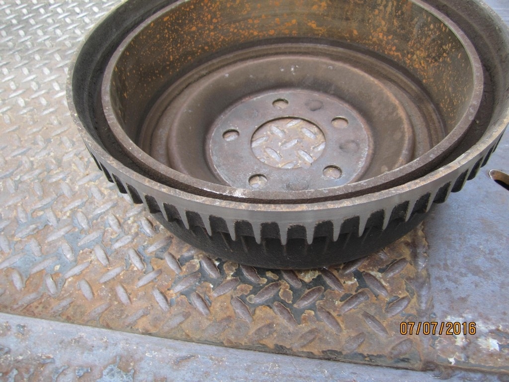

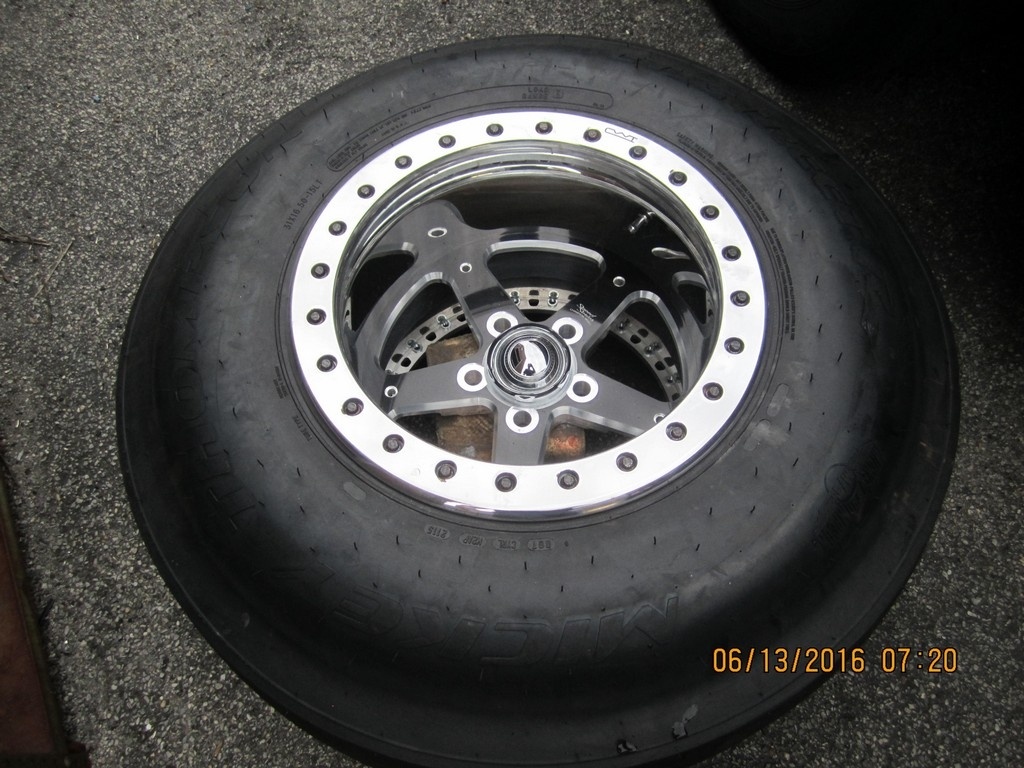

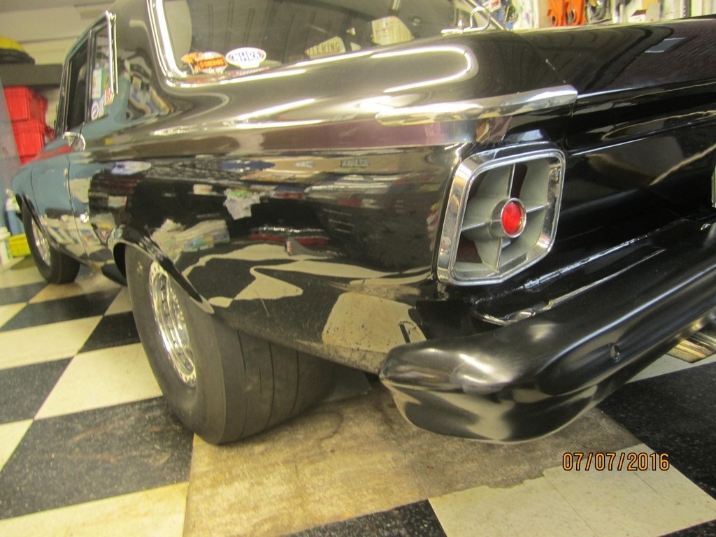

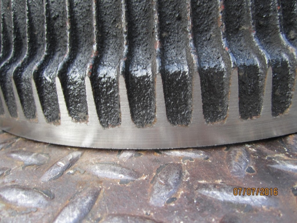

Got back a drum for test fit,installed one that fit perfectly.Can turn the other one down tomorrow.
Thanks to the few guys that offered me drums,you guys rock :thumbsup:
Love to see the end product. This should be interesting. I think your attention to detail is fabulous.
We love to see all your pics. Keep emailing coming

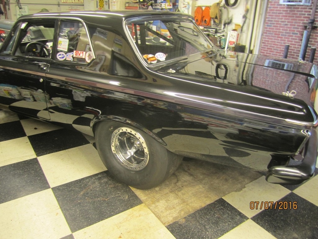

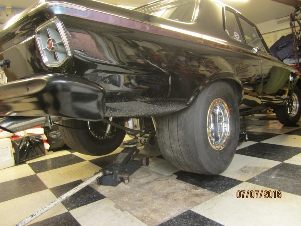

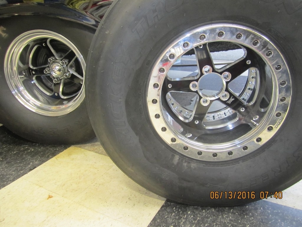

Cut the other drum and installed it. Spun the drums on tire balancer,they were within 1/4 ounce.
Pic's later,,,,,,,,,,,,,,,,
Thanks again for all your offers and,,,,,,,,,,,,,,COMMENTS!!!
