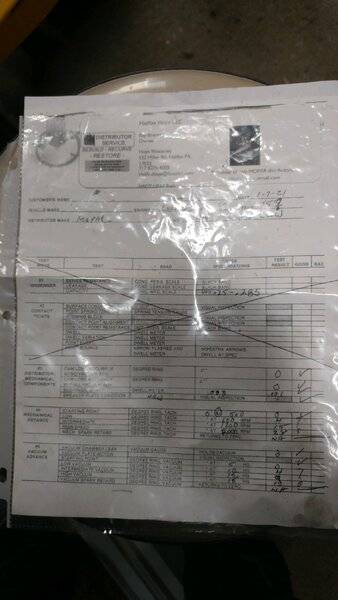

I know..i dont know what to do..it sure performs great though besides the pinging! It likes the timing! Being i set it at 20 btdc initially, where does it end up at total mechanical?
You have the sheet I sent you add the mechanical and vacuum together then subtract 20. That should be the total ATDC
Where did you hook up the vacuum advance hose to?
I hooked it to ported like you said. I tried unhooking it and it still acts the same as far as pinging. With the vacuum hooked up it cruises much better than it used to and there is no pinging at cruise or anywhere other than WOT
