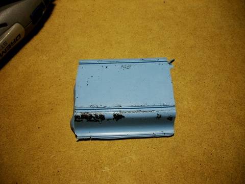

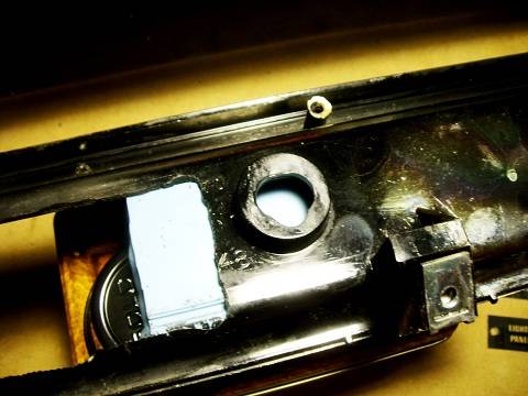

Here is the temp. mold for the non-rallye dash:

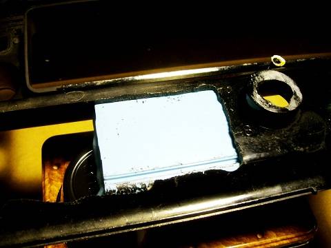

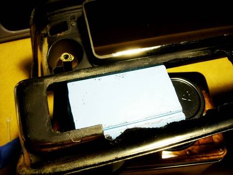

I'll be cutting the back of the dial hole and will be filled.
Perfect fit, will be filled with liquid plastic and section at a time til
completely covered. I'll cut the mold to fit on the end of the hole.

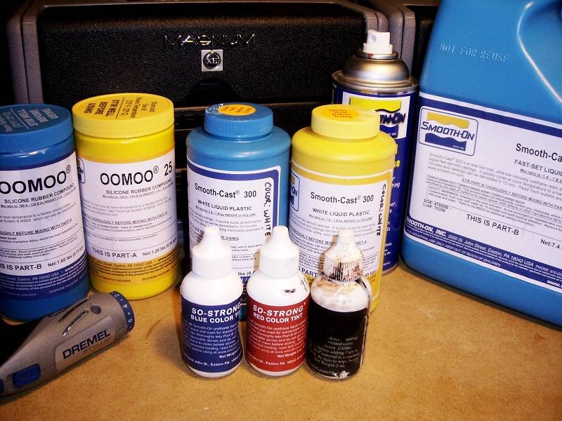

Some of the supplies I'm using.

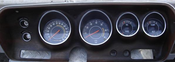

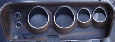

Hey, thanks magnum gt...I looked threw this post and seen the non rally dash insert and that is what I was thinking about for a flat section on the dash,,I have the rally dash and wanted to do something different and had bought a nordic flat digital six gauge some time ago for my wagon and havn't used it yet, thought it would be cool to use it in my roadrunner instead. So yesterday I went to the salvage yard and got one out of a satilite that was perfect,,just dirty.
I have restored a few 71-4 b body clusters. Over a number of years I tried to reprouduce the chrome paint. I got real close to getting the chrome sheen that I wanted. The problem is that it was not cheap so I gave up. I have some pics I will post when I find them. Then I was going to get some Alsa chrome FX. But that is not good for precision (sp) jobs like that. Eastwood also sells a product that works ok and can be applied with an air brush. The problem there is so much masking involved. You have to mask to spray the brown and black for the wood grain, mask again to spray the black around the gauge holes and mask again to do the chrome. Looks good when finished but once again the luster is lacking just a little. I think I'm going to give bare metal a try. Have you ever tried to do a long peice where you would have to butt two edges together? If so how do you cut it. Do you think over lapping and double cutting in an attempt to hide the seam would work or is this stuff too sticky? This is a great thread, Thanks and keep us posted. Take Care!

I found some.bezel 1.jpgnos radio delete.JPGbezel and tach.jpgrestored bezel.jpg The delete one is NOS. The others are a couple that I did for customers. One or two might not be finished in thes pics.
My latest one has NOS speedo, all nos gauges, Nos switches, NOS heater control, new blue filters, new lenses, and new gaskets. I still have to restore the bezel for this one.
View attachment 109052restored bezel with tach.JPGView attachment 109054 The delete bezel is an NOS piece. It needs some chrome touch up on the bottom edge. I put the pics up twice to make them a little larger. The click to enlarge doesnt work because I got them from another site I belong to. Let me know what you guys think good or bad. Thanks!
