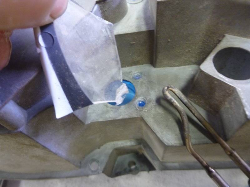

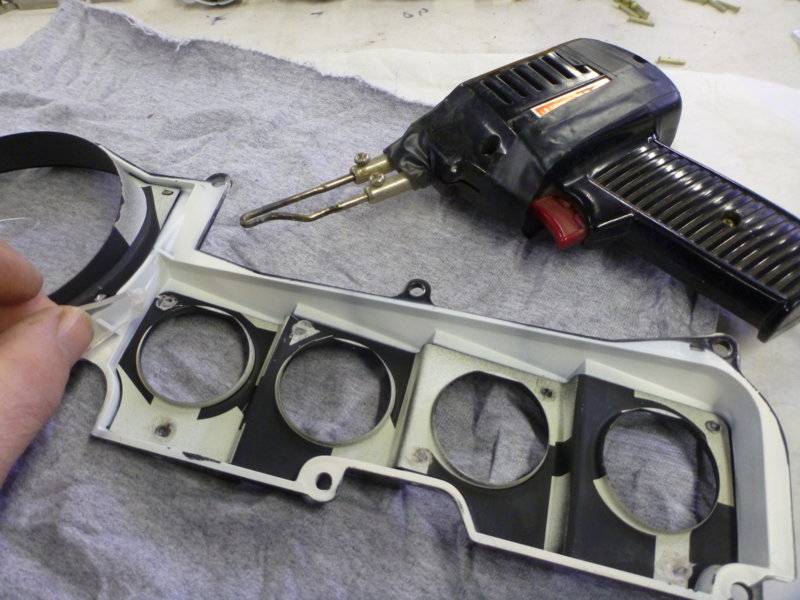

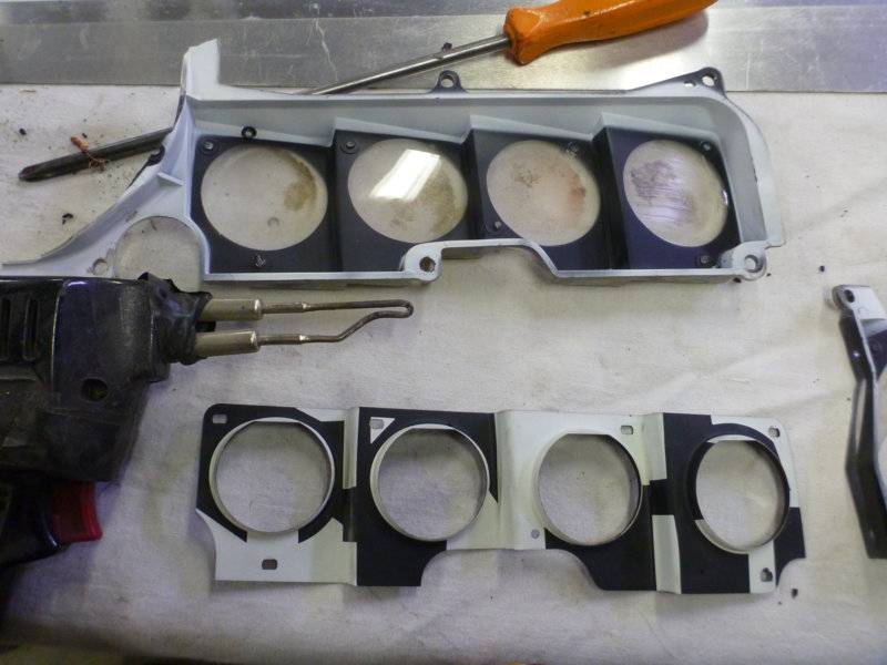

I'm assuming the plastic tabs are thru a light metal frame similar to a rallye dash. You heat the plastic tab and lightly pry to pop each one thru. The stub will then be the shape of the hole. Reassemble by putting in place and reheating / squashing the tab and where needed melt in some scraps... or if deemed necessary some super glue.

View attachment 598977 View attachment 598978 View attachment 598979
