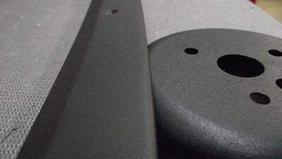

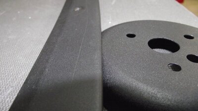

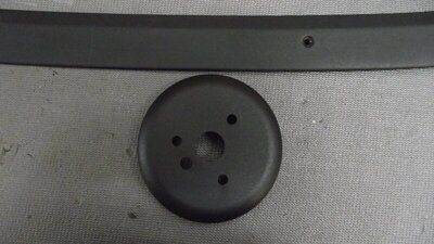

If its black then Rustoleum "textured" finish available at Walmart is bang on. BUT if you try to cover the area with just that it will be too coarse so ideally you want to shoot it first with flat black then "dust" it with the textured till you get the desired results. Trim strip is bone stock, horn ring is the Rustoleum. This was applied for full coverage so its just a tad too coarse. This is when I discovered applying a flat coat first was the solution. The other problem is doing the large top area of the dash. You can't maintain an even wet coat with a spray bomb and end up with flat spots. Shooting a flat coat first then dusting or fogging the textured solves that issue.
DSCF4066 (2016_11_22 02_37_15 UTC).JPG DSCF4069 (2016_11_22 02_37_15 UTC).JPG DSCF4070 (2016_11_22 02_37_15 UTC).JPG

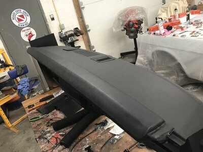

Reviving this to add a few pics of a new black/silver leatherette powder I just shot for the first time.
It's a really cool finish that does look and feel leathery, and on a once-in-a-lifetime project too, a famed Rocky Mountain Dash insert. (The glove box extension is getting here later after mods.)
The gauge pods and heater control area were done in a metallic silver to match his sample and clear.
I'm very happy with how it turned out.
