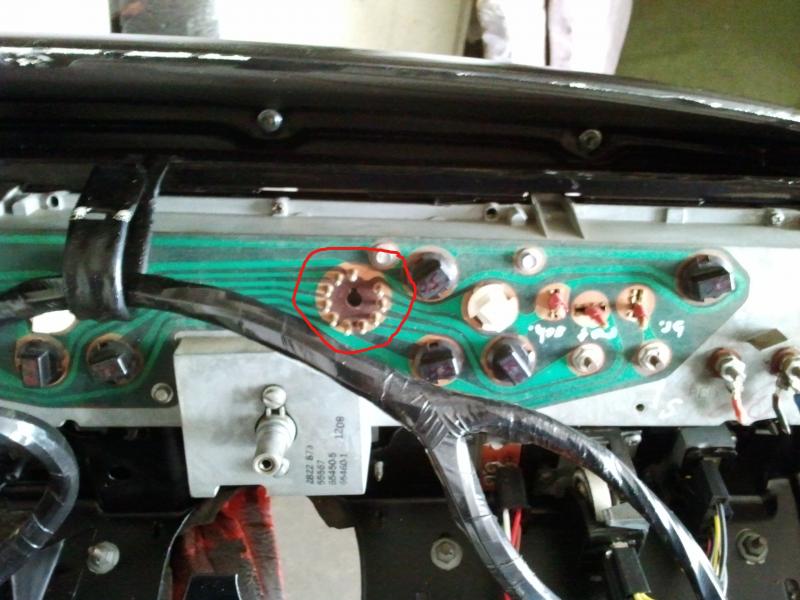

Hi,
I am restoring a 68 Road Runner and bought a new dash harness from MH wiring harness (Yearone, Classicindustries, e.g.). Assembling the dash, nearly all connectors to my (non-ralley) dash are fine but for one, the dash harness doesn't fit, even the colors are wrong. I attached a photo of the connector (red circle). Did you have the same experiences? How did you resolve this?
Thanks,
Thorsten

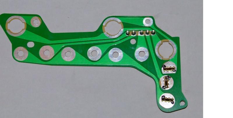

Oh-oh! I just bought one too, but didn't check if it plugged in and fit. It looks like it should. Do you have a photo of the M&H connector next to the male pins on the rear of the circuit board for comparison?

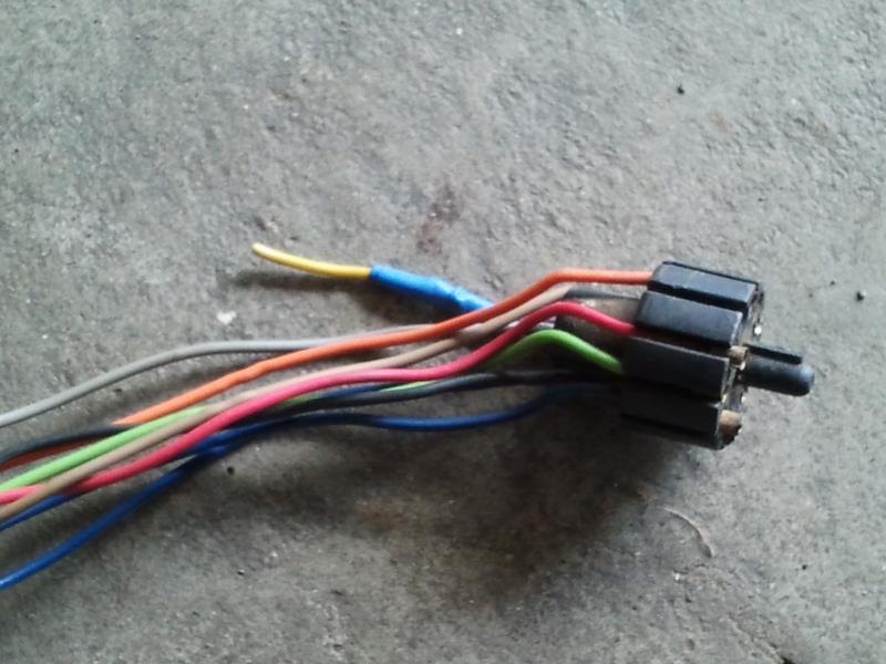

Yes, this is the connector on my old dash harness:

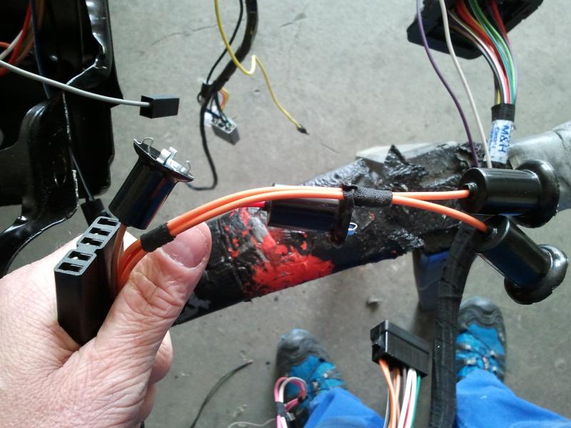

And these are the connectors on the new one (HU269B)... cable colors, number of cables and connector are completely different:
Did they send you a rallye dash harness by mistake?
Thanks for your feedback, I already have contacted the shop (Jacksautoparts). Hope that I get some feedback from them and the option to send the wrong harness back and get the correct one.
Mine doesn't look like yours. Mine fits. I think they did send you a ralley harness
