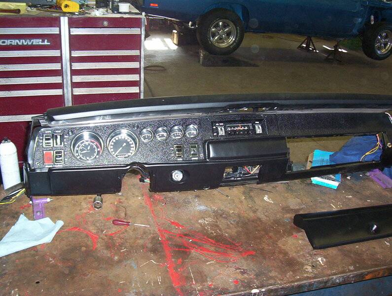

I had my dash on the bench. Hooked the battery up to the Large red on the bulkhead and grounded the dash frame. I was able to turn the lights on and check all the functions. I had a turn signal and brake light switch hooked up so all the lighting functions could be tested. I then turned the key on and was able to operate the gauges and test every circuit. The radio even played.
I don't think that is what the OP is working with. I could be wrong . In order to do that ,you must of had your ENTIRE dash wiring harness installed with fuse box along with all other wiring that is connected to bulkhead. And I have no idea how you got gauges to work with out them being connected to the sending units . Or your radio unless you hooked up the antenna somehow ? As well as blinkers as they are grounded threw chassis
I am not her to start an argument either , but to test the way you apparently did requires to take the entire body /chassis electrical system and re create it on the floor. Not something most people do
Look at my picture. Yes it is on the bench. Load only makes the flasher open. You can still check the wires for voltage. Gauges can be checked for being able to function by grounding the circuit for each Gauge. Yes I plugged an antenna in. Very simple and elementary to run needed tests. No sense over complicating things.
