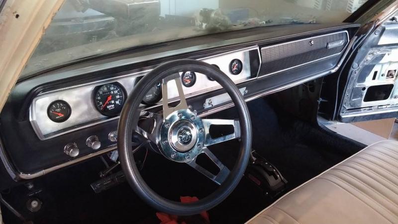

dash is done!!!!
67 coronet
12:15 AM
Nov 28, 2011
2,622
871
las vegas
1554582_232610043600599_2301941177389064172_n.jpgabout dam time.
Looks good 67, I wish they would have put those same dashes in the 68-70 B Bodies too. Nice
Man that looks sharp. Did you do all that yourself or prefab?
That looks really good - More info please, is the back panel aluminum? What brand of gauges and which gauges did you install? Any more pics? Thanks

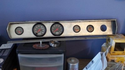

the backing plate is cut from a stop sign and the guages are autometer.2012-06-06_15-06-44_805.jpgthe surround is cut from a very bad original dash and just made flat to fit up against the aluminum.
Sweet!!! This is what I've been wanting to do with my 66 Belvedere. I'll have to relocate my heater, wiper, and headlight controls though. Vintage Air makes a AC/Heater control module that will fit in the center of the dash, between the glove box and gauge cluster. I can put the lights and wiper controls on the lower left like you did. Did you bend the sheet metal around the back of the bezel? What size speedo and tach are you using?
yes,i left tabs at each screw location and bent them over to line up.i am pretty sure the tach and speedo are 3 3/8 inch gauges.just measure the space between bezel edges,that is what i used.small gauges are what ever you want.designed it on paper first.
Thanks! Will definitely design on paper first. This and a AC system will be my summer project.

the backing plate is cut from a stop sign and the guages are autometer. the surround is cut from a very bad original dash and just made flat to fit up against the aluminum.
