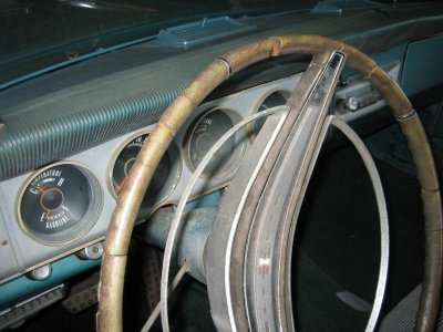

Mine has a dash pad. It's held on by clips in the top of the dash. You should see a series of holes running along the whole dash (maybe 6 or so?). It also has a trim piece that's held on by interior screws along the underside of the dash.
Here's a pic of mine. The lower trim piece isn't on it in this photo. It attaches along the bottom edge just above the gauges.
64Bel thanks for the picture. looks like Im going to have to add that to the list of stuff to get.
