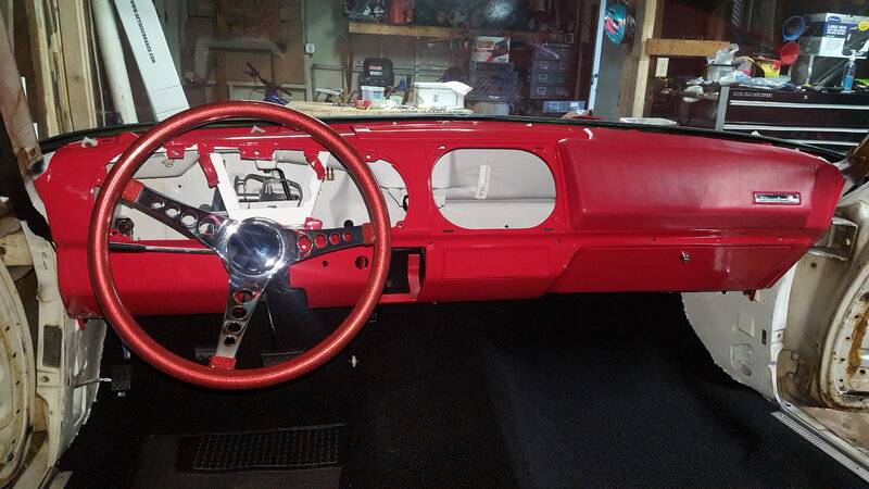

I have ordered a new pad and removed the old pad, now o just have to find a place to dye it.

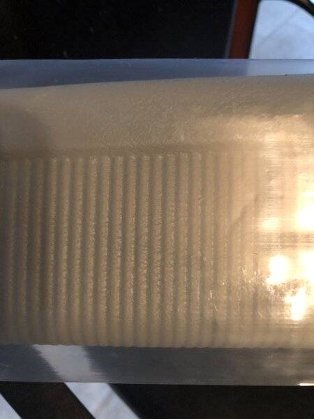

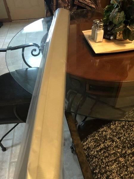

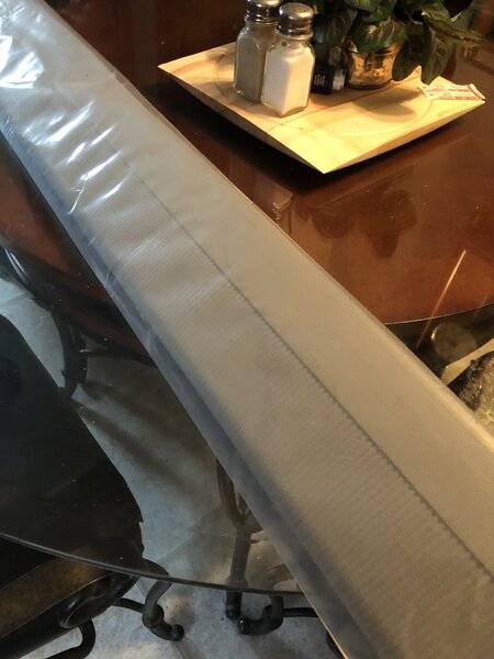

My new dash pad showed up today, I ordered it in primer so all I need to do is color it. There is a steel strip that runs the length of it for the mounting clips to mount to, just like the original.
