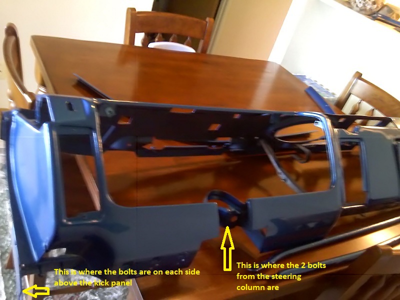

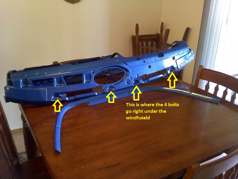

If it is anything like my 72 Road Runner you have 4 bolts across the top right beneath the windshield. Then you have one bolt on each side under the dash above the kick panels near the door jamb. Then you have your 3 bolts that hold your steering column up. Only the 2 in the front actually go around your dash. I have attached a couple of pics with annotations when I had mine out. I hope this helps.

Thanks, did you have to take the window out?

I did have the window out, but I am not sure if it is a requirement. It did make it extremely easy to get to the bolts though. As far as the gauges, the biggest trouble I had was getting to the light switch and wiper plugs. As well as unhooking all of the power cables on the gauges. It just takes a lot of patience and contortionist act to get it done. I will say, if you can, have your steering column unbolted and dropped down out of the way. That way you can work the cluster out by pulling the top out and down and work the rest of it out as you get things unplugged. I hope this helps.
