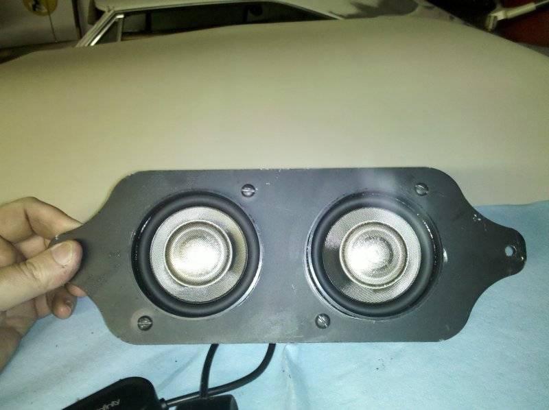

The dash speaker in my 82 Coronet is a 4x10. I used an adapter.plate to add a pair of 3.5" Infinities. It came out very nicely.

The mounting plate was sold by a member here. The Infinity Kappa magnets are pretty big and hit the heater cable originally before I installed the vintage air system.
Do you remember which member sold theses brackets?
