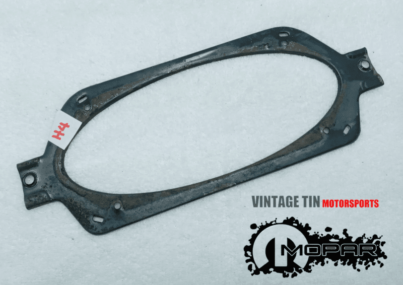

There should be 2 small studs near the defrost vents to mount the speaker. The speaker also requires an adapter plate from the factory.
This is the adapter plate:
The speaker needs to be a shallow design or the radio will hit it before it is on its rear mounting bracket. Many aftermarket speakers won't fit in a 68-70 b-body.
This is the adapter plate: View attachment 1932217

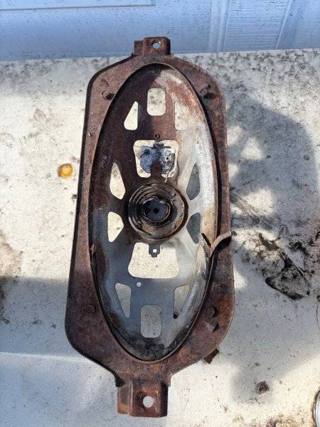

Would you believe that just yesterday evening I tossed a rough bracket and clobbered speaker in my recycle bin, thinking to myself now watch some post pop up on the forum where a member needs this junk? Luckily it was still on the top, if you need it we can figure out how to ship it. Needs a soak in Evaporust
Do you still have it?

Getting it refurbished as we speak. The radio guy knows just what I am doing. He has did an AMFM radio for me before an added a mp3 jack on it also. He knows all about the ohms and has actually boosted the output of my radio. Got my speakers from electro-tech which fit perfectly.
