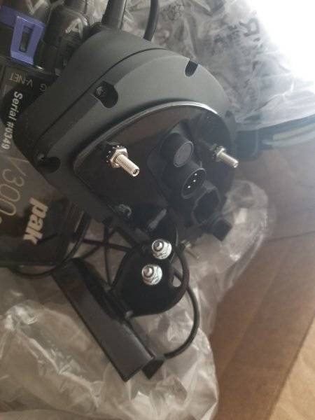

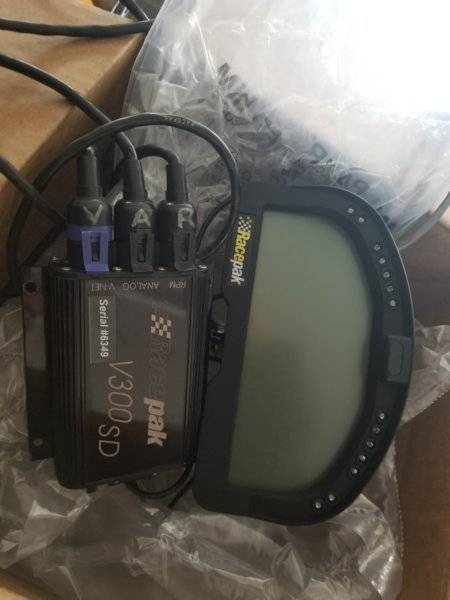

Here's my new addition

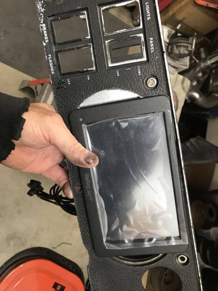

Just got this new trick dash mount.
Never seen it before. Nice powdercoating on it.

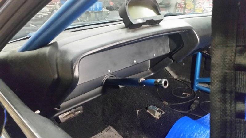

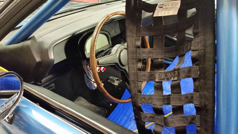

Wiring my car up from scratch over the winter. I have the Racepak IQ3 street dash. Monitoring 25 sensors once done. Oil pressure, oil temp, water temp, GPS for speedo, drive shaft speed, fuel pressure 1 for motor, fuel pressure 2 for NOS stage 1, fuel pressure 3 for NOS stage 2, NOS pressure 1, NOS pressure 2, bottle pressure 1, bottle pressure 2, engine/pan vacuum, O2 left, O2 right, all 8 EGT's, trans temp, trans pressure to start. I quit adding up costs......I couldn't run any gauges within my stock dash panel due to the knee bar of the cage running where gages would go so I made this mount to my tubular steering column.
