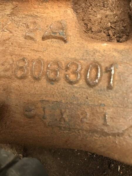

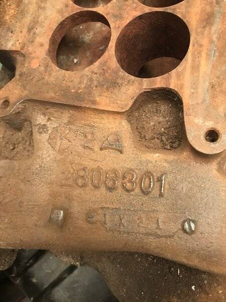

Hi there, I know u guys are pretty sharp here on this kind of thing. So I’m asking for some help on a 68 383 4 bbl intake. So here it is. 1 X 2 1. Thanks. Kim
Ok, here ya go. Kim

It looks like that part number is coming up as 68, like you said. My guess would be 1/21. Never saw one with an X but a quick search on the part number returned several pictures with an X or - between the month and day.
That would be my best educated guess. Jan 21st.

So could u please tell me if that intake would be the correct one for this tag ?

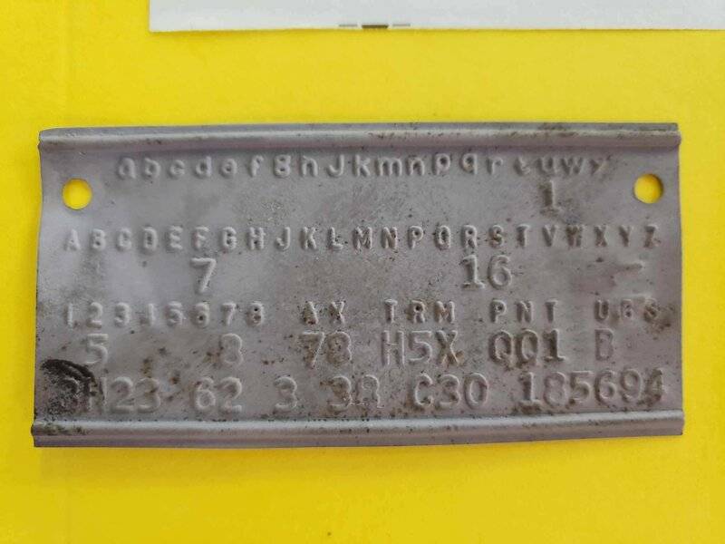

I’m not positive I have the date format correct. Your fender tag is C30, I think that’s Dec 30th. Happy BDay to your car today.
If I did the intake correctly, you car was built before the install was cast.
Again, assuming I have it right.
See if some other chime in.

Wow, Happy Bday to my car, haha Build sheet says Dec 30 1967
engine stamp says 12.26 67 so i need an intake earlier ?
