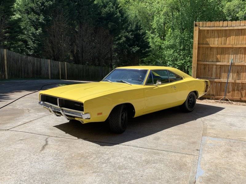

I have a project idea for a Daytona charger and I was wondering which would be the best starter doner car, a ‘69 or ‘70 charger? Or something else even? I have a ‘69 charger already but it is a running and driving car (see pics) and am debating on obtaining another project instead of using the one I already have.

Whatever you decide do not touch the yellow charger, it looks awesome already.
