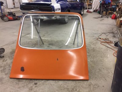

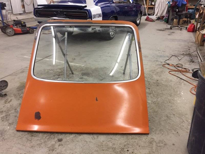

      You can also use a hatch from a Pontiac Astre, it was the cousin of the Vega.
      I just scored a nice one from a salvage yard last week for $100.00.
      The Vega/Astre window has a slightly different shape than the Daytona's. The glass flares out at the bottom a bit and the bottom edge has a slight curve.

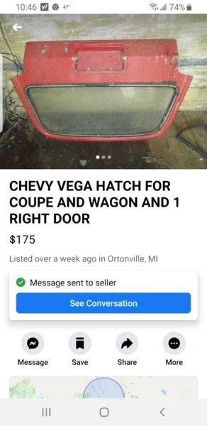

        No, you need the hatch back style, not the station wagon like pictured.

        The wagon window is actually more like the correct shape of an original Daytona /500 rear window, I wonder if the demensions of the glass are close?
