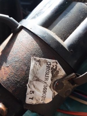

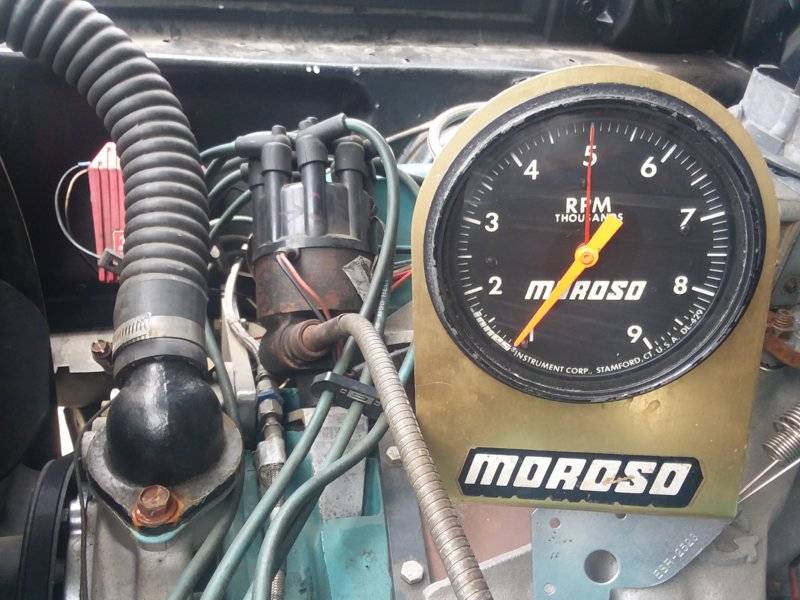

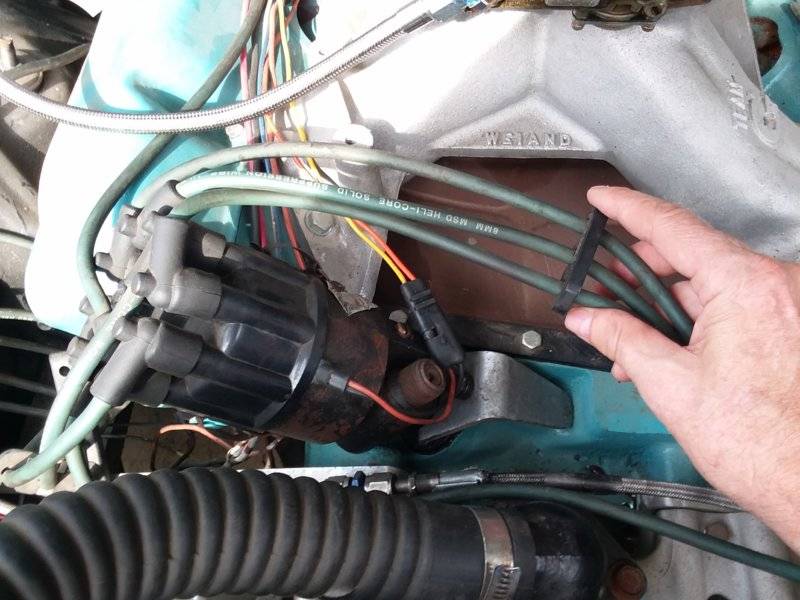

I've got a direct connection tach drive distributor, 3690201, and i would like to know some more about the advance curve and centrifugal advance in it from DC. This distributor was never oem, has no vacuum adv, is cast iron, uses a dual point cap and rotor.
I should be able to plot it off of the balancer tape, but i think it is already advancing some at a 1200 rpm idle.
I have no idea where to begin to look for this info, can anybody help me out?
