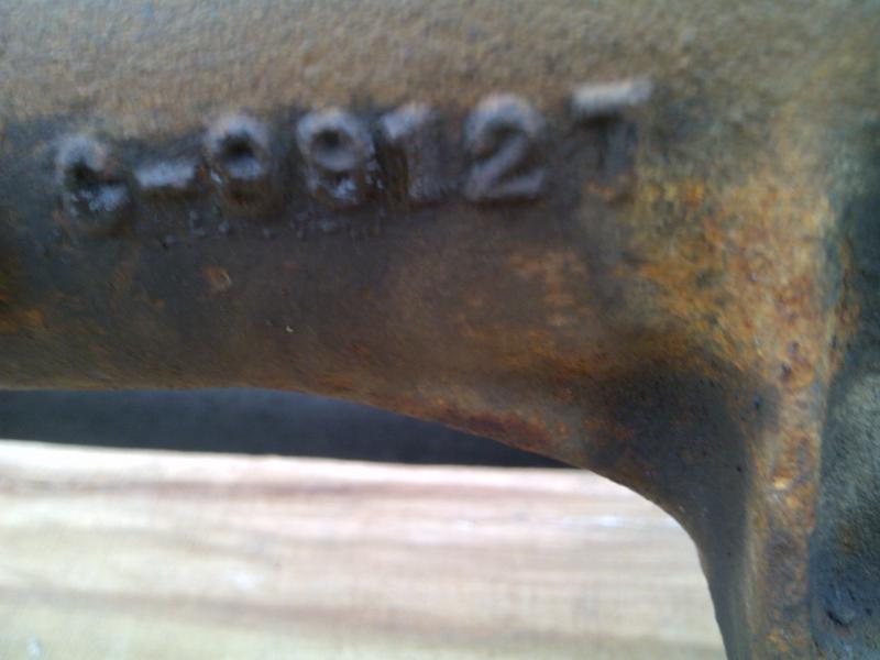

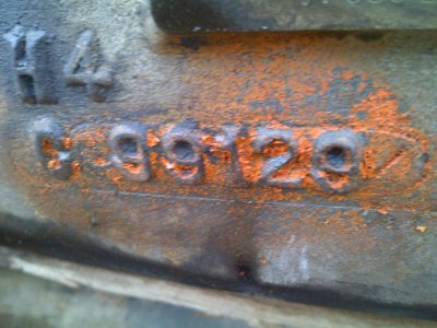

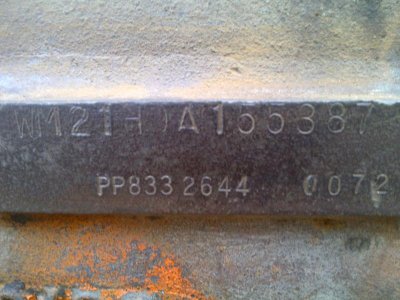

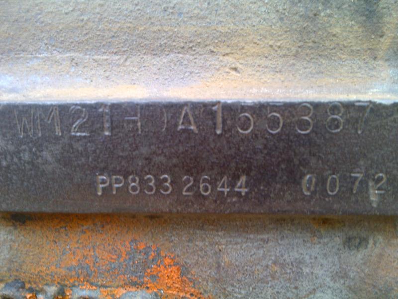

Tried to clean the outside of the tranny today. 3 cans of engine degreaser and 6 cans of brake cleaner and a wire brush. ALOT of crap and grease came off of it. Still have some work to finish cleaning it before painting the case but at least I can put it up on the workbench without it totally making a mess. Only damage I saw was one bolt snapped off in one of the shifter mount holes. Gonna soak it with PB Blaster for a few days, then drill and extract it. Hopefully the threads will not be damaged. The gears and synchros inside the case are in excellent shape and weren't even that dirty. I sprayed them down with brake cleaner to get any solidified old lubricant off and then with WD-40 to protect from rust till I can order the rebuild kit. Any opinions on where to get the rebuild kit? Brewer's looks pretty complete. Are the gaskets that come in their kit the best to use? Also, any suggestions on what specialty tools I will need to reassemble the gears?
Here are some pics. Looks like its a 23 spline, 1969, from a Coronet/Charger (WM21H9A), 69 tailshaft housing with 307 bearing (C-99127). All in all, I'm pretty happy with it.

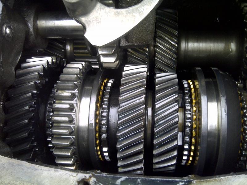

Trying to decide on the 833 rebuild. My brother, who owned a transmission shop for 5 years, is suggesting I might not want to totally rebuild the gearset if the synchros and gears are in excellent condition, which I think they are. He said that if it is shifting smooth now, not to mess with it since it is an intricate reassembly and just change seals and bearings. So, he has placed some doubt in my mind. Is his suggestion sensible? Anybody have any thoughts on the skill level needed to totally disassemble and reassemble an 833? The last thing I want to do is screw it up and grind the gears and synchros up. Another option is I found a relatively local Mopar specialist who will rebuild the trans including blasting and painting the case for $500 (which includes the $100+ rebuild kit). Is it critical having someone with experience do it? All opinions are welcome. Thanks gents.
