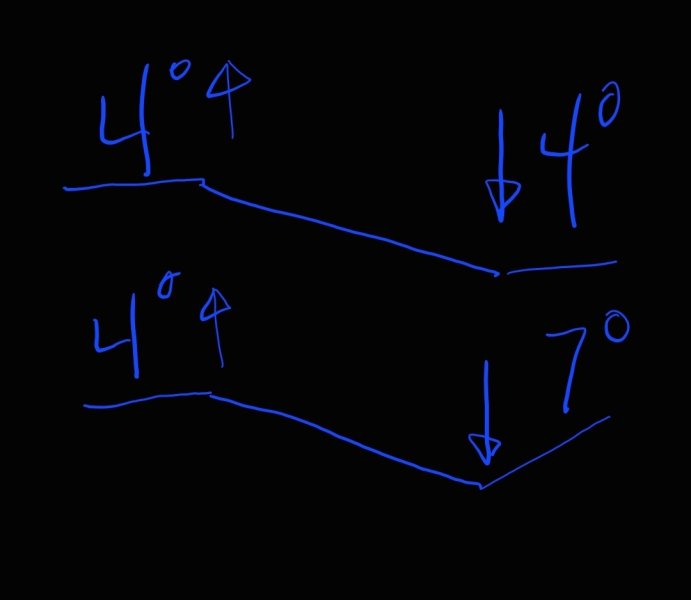

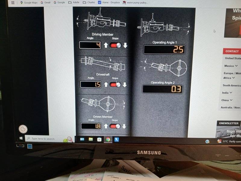

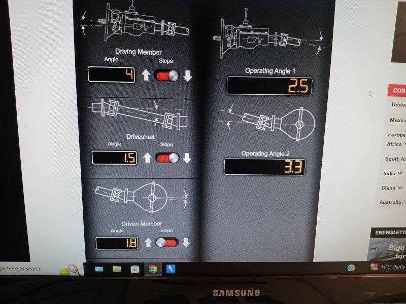

Drawing below shows my measured driveline angles. I went to the Spicer website and pluged in the numbers. Problem is, for me anyways, not sure how to input the correct data for the pinion. The Spicer drawing has me wondering which direction (which arrow to choose in Spicer calculator) is correct. Brain fart for sure. I either come up with operating angle "B" at 0.3 or3.3. Perhaps someone could offer their expert advice here. I'm trying to calculate how much to shim my pinion to be parallel to my trans tailshaft.

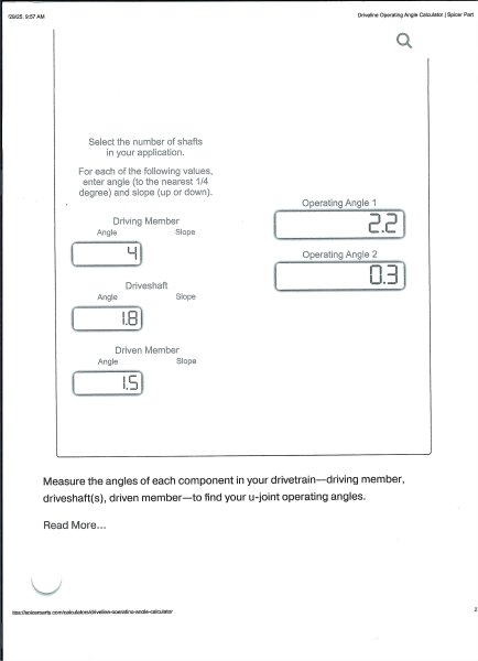

First off. If your angle calculations are correct, you entered them wrong in the Spicer calculator. You swapped the drive shaft angle and the pinion angle which is not the real problem. The real problem is you didn't change your pinion angle to down.
Here is the correct readings. Angle 1=2.2 Angle 2=.3
IMO, I believe you need to raise your pinion angle up at least 2 degrees (maybe 2.5) to get in tolerance. Ideally your pinion angle and transmission angle should be the same. That way when your pinion moves up and down, your drive shaft angle changes with it and your numbers between angle 1 and angle 2 stay the same.

OK, this is becoming a bit more clear. I do have a set of 2.5 degree shims. When I do a visual at the driveshaft / pinion connection, there seems to be hardly any angle at all - almost straight in line, which I understand is not good for the u-joint needle bearings.
That is because it is only .3 degrees of an angle. Put those 2.5 degree shims in to tip your pinion up to 4 degrees and you will be golden. Don't worry about the driveshaft angle. It is constantly changing while you are driving anyway. As long as your Transmission is lined up with the Pinion at rest. You can't get it any better. It don't matter if your driveshaft is angled up, down or level.

You want the engine and pinion parallel under acceleration. Which means the pinion needs to be 3-4 degrees nose down from the engine angle. Quick sketch of parallel under load (top) and at rest (bottom).

According to your drawing you are right there. 2.5 degrees down from driveline angle.
