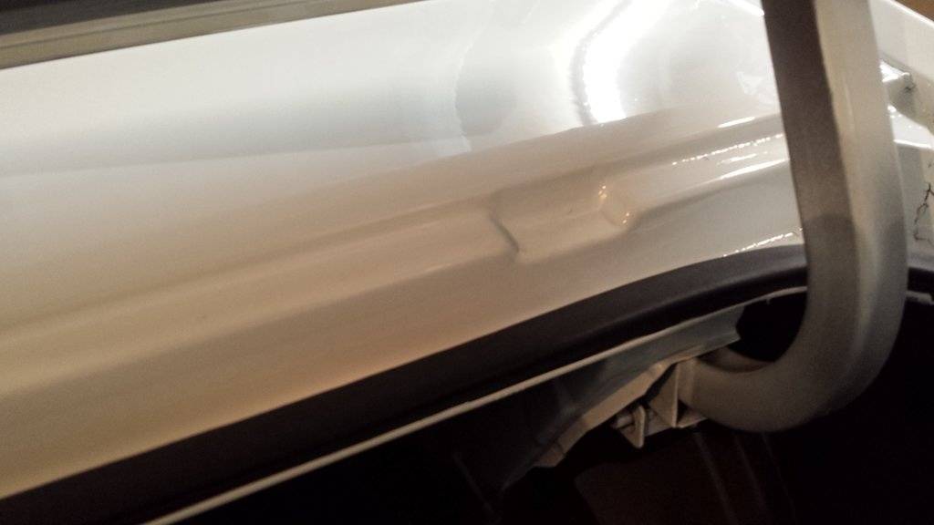

Are the 71-4 Charger deck filler panels the same as the 71-2 or 73-4 Plymouth panels? Just asking out of curiousity. It seems like they would considering all 71-4 B body 2 dr cars all shared the same roof skin and rear window glass.

71-4 Plymouth is the same
71-4 Charger is the same.
Plymouth has two notches the Charger does not have.
AMD pieces are Plymouth based. Those notches needs to be removed/flatened from the AMD pieces to fit it on Charger. They meet the hinges bracketing. Otherwise is a perfect fit. Dunno why Plymouths are on that way, or whats the need to get diff shape there on Plymouth hinges support
BTDT. Got that panel from AMD for my Charger and is already installed
( yes, al 71/74 2 doors B bodies, Plymouth and Dodge uses same roof skin )
