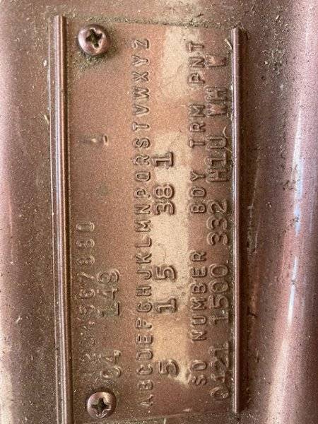

Please help decode this body tag from 64 fury.
You'll need the first four numbers of your Vin also, located on the driver's side door jam. Some plants had different codes than others.
Jefferson MI. car hard to decode 4/21 production date cloth vinyl high trim copper bench seat. Sandalwood metallic. The W might mean stripe color or top color not sure. 332 Fury hardtop.
3341 is the Lynch Road, MI. plant.

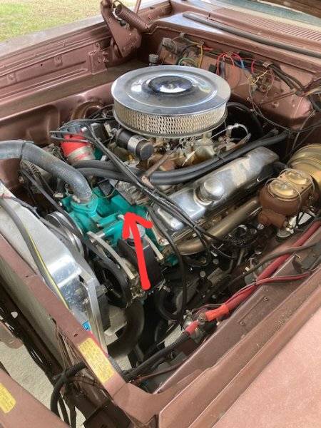

Take a picture of the engine pad stamping in front of the intake. (Red arrow) Or write down what you see there. (Numbers, Letters)
The 318 was the standard engine for your car. Nothing stamped under the AB means standard engine.

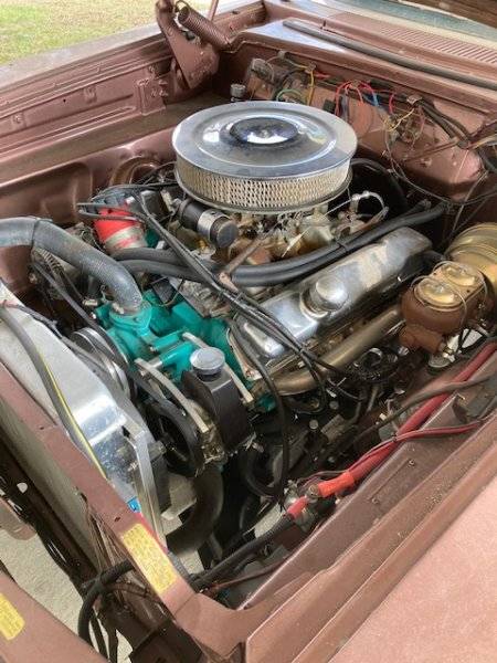

I think this engine is a 440. Not original.
