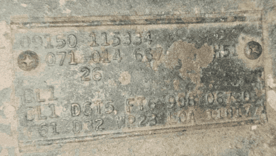

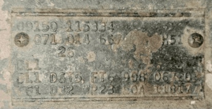

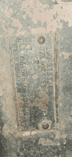

Hi everyone I’m having trouble decoding a few codes can anyone help thanks
70 Coronet 500 2 door hardtop
BL1 beige paint roof and body.
FT6 tan upper door frame paint
D6T5 tan bucket seat interior
383-2bbl
727 auto column shift
Air conditioning
26" radiator
Scheduled prod date 9-8-1969
Lynch road, MI has tags with unique codes.
383-2bbl
Air conditioning
26" radiator
Thank you for helping me with that
