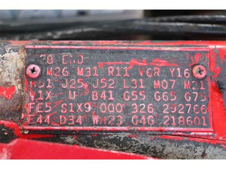

Hi all, I'm still pretty new to the decoding of fender tags and build sheets and wanted some help with doing my fender tag and build sheet. I did do a little bit of research through mymopar's decoding system. Came up with this:
WH23:
Dodge Coronet,Charger
High
2 Door Hardtop
G4G: 318 150HP(net) or 170HP(net) 1-2BBL 8 CYL
1974
St. Louis, MO, USA
218601: Sequence number
E44: 318 cid 2 barrel V8 230hp
D34: Light Duty Automatic Transmission
FE5: Bright Red Exterior Color
S1X9: Trim - Unknown, Unknown, Black
000: Full Door Panels
326: Build Date: March 26
292766: Order number
V1X: Full Vinyl Top, Black
U: USA Specifications
B41: Front Disc Brakes w/Standard 10in RR Drum
G55: Outside LH Remote Painted Racing Mirror
G65: Outside RH Manual Painted Racing Mirror
G75: Dual Painted Racing Mirrors
???: Unknown
J25: 3 Speed Wipers
J52: Inside Hood Release
L31: Hood/Fender Mounted Turn Signals
M07: Unknown
M21: Roof drip rail moldings
M26: Wheel Lip Moldings
M31: Belt Moldings
R11: Radio Solid State AM (2 Watts)
V6R: Longitudinal Stripes, Red
Y16: Sales Bank
???: Unknown
END: End of Sales Codes

H51 A/C
28 inch radiator ( with uses to be acomplished with A/C )
that's what I think
EDITING
Oh!!! and
M07 opera quarter window without louvers ( which your signature already states )
Yep! I was told that M07 code being present with the WH23 code would mean it's definitely a spring special, I'm not sure how many of those were built but I know I've only ever seen a few besides mine, including that blew one you showed. Also - it was mainly a dress up package, right? because my car has almost all the interior pieces and the grille inserts a Special Edition would've had, despite it being a base?
No! Spring special is a package that COULD get the M07 quarter glass but is not part of the package. Spring Special Package is A77 on code and it got am special vinyl and cloth interior treatment, body colors were tipicaly brownish shades and the standard rallye stripe was the Bronze one. Standard cluster too, not rallye. Yes is just a trim package, nothing performance

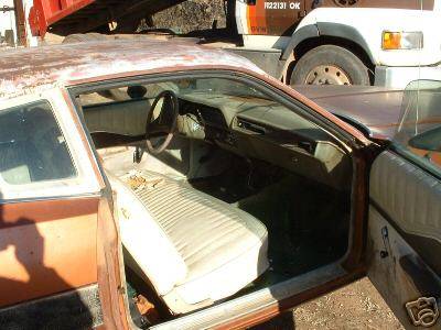

I see... I heard they had special interiors but I've also seen another one that had an interior like mine, lemme see i can find it and get a pic of my own

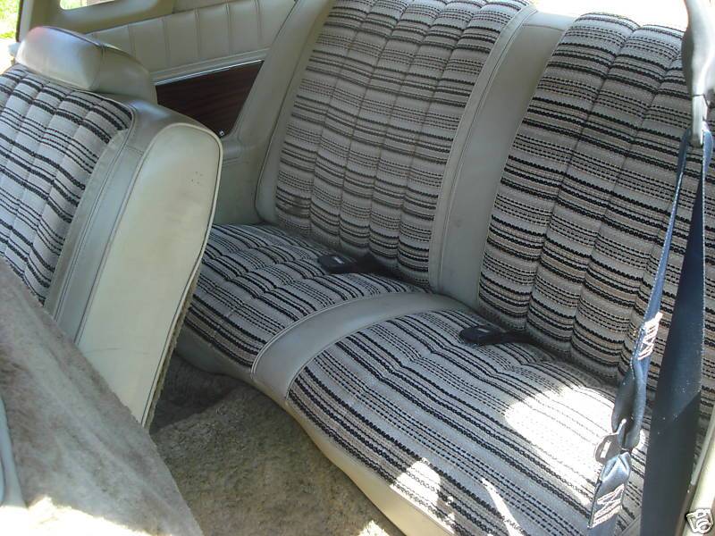

yes, Once I found an Spring Special with full Vinyl maybe ? setup on ebay. Or cloth and vinyl but all parchment, and the fender tag was A77. I guess you can get what you pay after all. But just talking about the standards

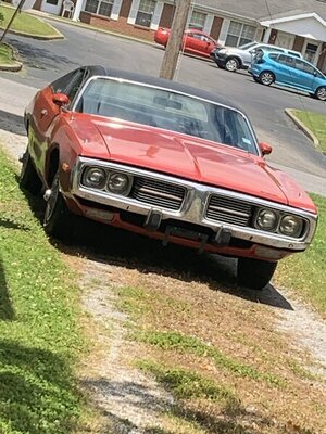

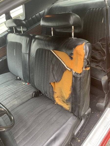

Alright here’s a pic of my interior (taken before I cleaned the carpeting and seats up) and a pic of those grilles I was talking about. Also a pic of the car from “back in the day” when it was new, with the chrome wheel well opening trim and the side stripes

well as mentioned the Spring specials are normally "brownish" body colors what will match with parchment interiors
From an attachment recently posted talking about the same
Huh. That's pretty interesting. So mine is a celeb roof car but not a spring special after all - that package, with the earthy colors and interior treatment, sounds so 70s i love it.

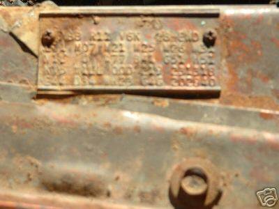

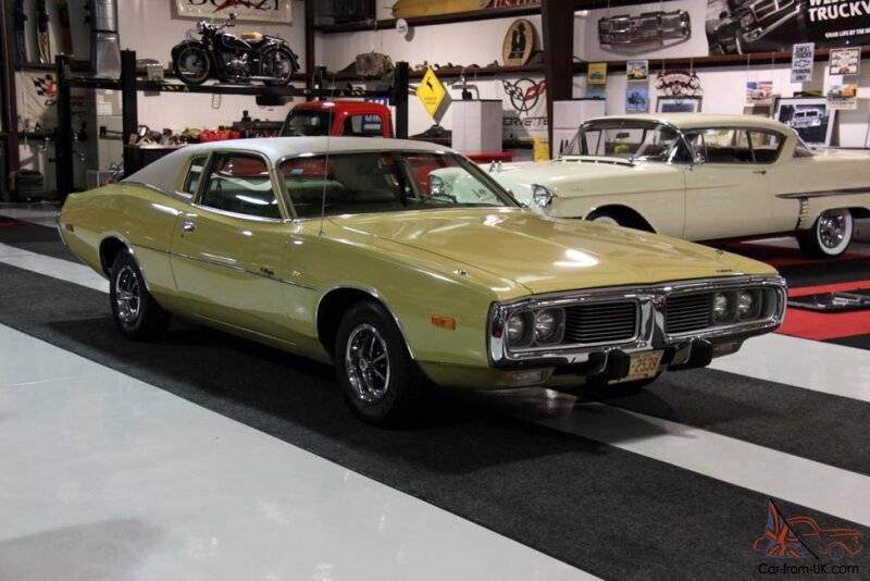

Here's the one I was talking about, it's a spring special car without the interior makeover and no stripes- or at least the seller said so, maybe just celeb roof?
