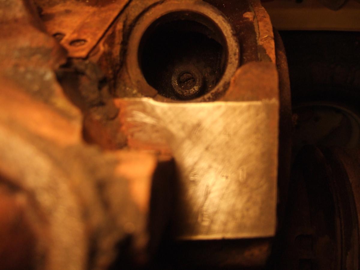

SO...any chance you can post a pic?

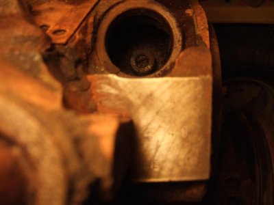

This is the best I could do
YOu can barely make out the bottom of the 7 in the top left, you can see the 4 in 400 also on the top row.
If you look closely in the middle of the pad you can make out the 2 and the 41 (blurry but there)
and the E is on the bottom left a little blurry.
Ok I think I figured it out, after some more research (picking up a book I had in the bookcase) I think I have it deciphered. After reading a bit I went back out to the engine and sure enough there is a barely legible T right after the 7 which according to the book "7T" = 1977 Model Year. The 400 is the engine size.
THe 2 is the month of manufacture or February, I cant make out the day and the "41" is the number engine that was built that day. So it was 41st engine built on february ??.
THe "E" stands for Cast Crankshaft and to the right of the E is a maltese cross which means it has a 0.001 in undersized crankshaft.
