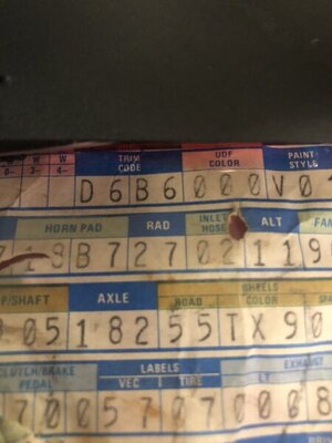

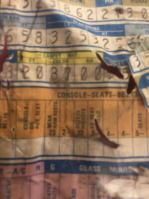

I am wanting to replace the carpet and seats in my 74 Charger. I have the build sheet and don’t really know what to look at. Would trim code be the interior color? The trim code on mine is D6 B6. Or the carpet code is 20 B7 00. Attached are the 2 codes. Just need seat color and carpet color. Thanks!! New to this.

D6B6 (Vinyl bucket seats in blue) interior with the B7 (dark blue) carpet.
My vin is indicating that my charger is a 1974, but I am finding that dark blue 07 did not come in the 1974s, but did in 1973. Could my car be a 73? Also, it has loop carpet and looks like cut pile came in the 74s. Confused, any help appreciated!!
My 74 has loop carpet and it was built in January, not sure when the change over happened. Get the cut pile. So much nicer I even will put it in my 71.
Biggest indicator between 73 and 74 is the trunk pan 74 had a big hump in middle 73 was flat
Maybe built in '73...
