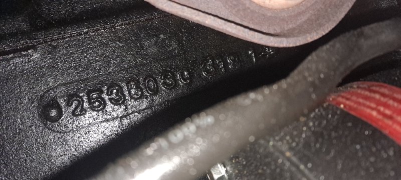

2535030 318 1-? (can't see the rest due to the exhaust manifold)

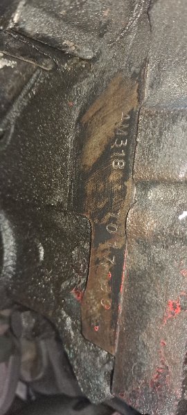

4M318 10171892 (may be misprinted?)

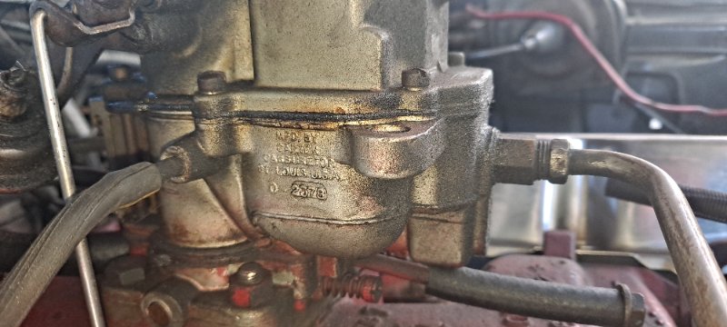

Carburetor is a Carter 0-2378 2

The pictured engine with engine number 4M318 10171892, et.al. is a 1974 model year 318 built at the Mound Road Engine Plant in Detroit, Michigan, on October 17, 1973. It was the 1892nd engine built that day at that plant. "2535030" is actually 2536030 which is the casting number for a 1967 - 1975 318 block. "318 1-?" is the suffix to the casting number, also denoting 318.
"0-2378 2" is the casting number of the main body of the carburetor, not the carburetor model number. That body casting is part of a Carter BBD 1-1/4 two-barrel carburetor. The body was used in 1974, and other years. The model number was originally stamped on a metal tag under one of the bowl cover screws, which is often missing if the carburetor has been taken apart.

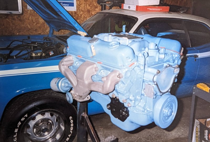

By the way, that 318 was originally blue, so with the black and red paint, plus chrome valve covers, etc. some things have been done to it. The blue would look similar to the engine in this image:
