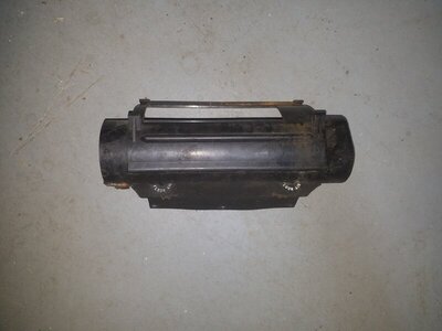

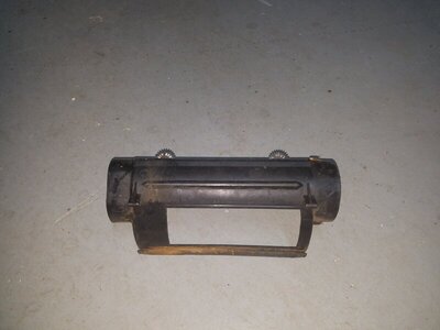

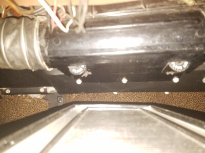

On 67 Plymouth - not sure if Charger is the same - there is a black plastic "box" that attaches to the interior side of the air box over the door. The driver and pass. side vents attach on left/right with flex hoses like the defrost - driver's side is 2 pieces that connect at hole in dash frame above steering column. Top opening has rectangular flex hose that goes to center dash vent.
Thank you. Yes, the flex hose that goes to the center a/c vents is what I'm looking for. Do you have a source? Or a picture that I might try to fabricate something?
Thank You. That is what I am looking for. At least I now know what it looks like. Picture was very helpful.
Let me know if you need more pics or dimensions. I'd consider selling my spare if it fits and you're interested. I checked my 67 parts book, but I'm a little unclear on interchangeability between Dodge and Plymouth based on the way it's notated. It doesn't have a separate call out for Charger so I'd assume it's at least the same as Coronet.
Had another thought and checked the center air vent. Parts book lists different p/n's for Belv. and Coronet/Charger so that could mean the vent tube is different as well.
