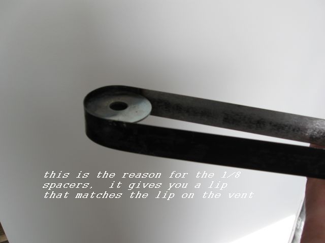

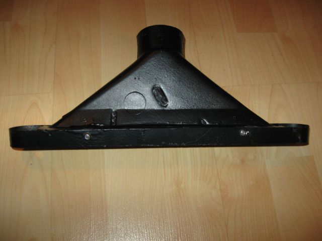

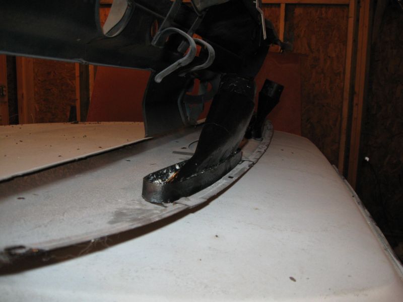

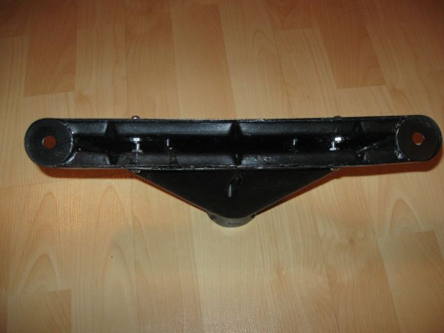

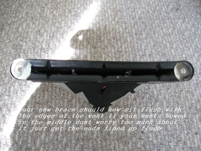

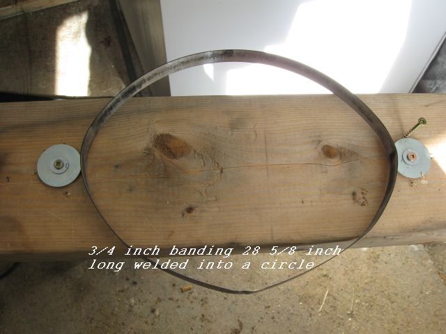

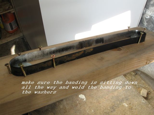

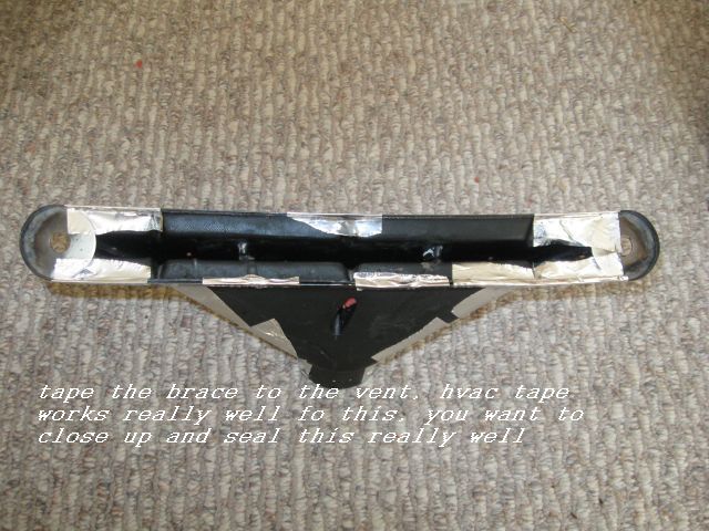

hi there, like a lot of us my defrost vents were trashed in the thin area that bolts to the dash. i fixed mine with two 28 5/8 lengths of 3/4 metal strapping that you should be able to get at your local lumber yard, 2- 1 1/2 washers,some fiberglass resin and some silver hvac tape. some welding and assembily required. if i was to do it again i would only pour the resin 1/8 thick to seal the vent and fill the rest with a good silicone. hope this helps some of you out with yours. ron

I am going to dive into this fix myself soon enough. One note you should be aware of, and I will check when I head home tonite to confirm, is that these ducts are made of polypropylene or polyethylene and fiberglass resins will not adhere long term. These plastics have a polyolefin base that need special surface modifiers applied before any resin will work. And as a further note only epoxy or urethane based adhesives will work. And another precaution...absolutely no adhesives work on polyethylene plastics. These vents are likely polypropylene however. Ingenious fix, just needs the right repair adhesive/prep procedure.
One another note, I will attempt a plastic welding repair on mine, and if it is successful I may offer my sevices to other fbbo members. At the end of the day, its only plastic!

thanks for checking into the plastic 66_b_body. having the right adhesive for these would help a lot. i was thinking that a couple of 3/16 bolts that run through the banding,resin and vent would hold the whole thing together.that way the resin is nothing more than a spacer between the vent and banding. thanks to all of you for the comments ron

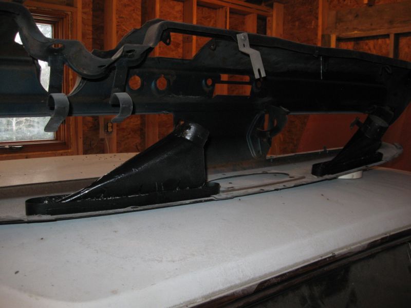

not the greatest pics but a couple of shot of the vents in a spare dash. tifu? good heavens man! use rendered sugarbeet juice...it'll stick to anything!
